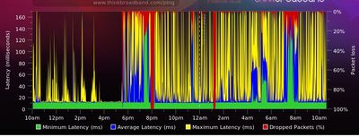

Re: Low Broadband speeds
My TBB graph for today. Not very pretty.
Posts: 23,758
Thanks: 8,443
Fixes: 357
That is HORRIBLE, @Sarah8987 !! What did the response to your fault report say?
