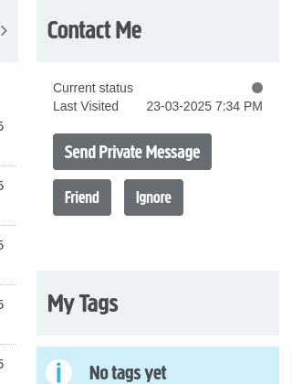

How do I send you a PM? I tapped on your profile and got the About page but there's no hyperlink on the Contact me "button".

@Mardler Try the 'send private message' button (in grey).

jab1, I don't have that option.

Strange - I do.

jab1, I got that with nothing under the Contact Me box. Tried a 3rd time and it worked.

Glad you sorted it, but I have no explanation for why it didn't display correctly.
