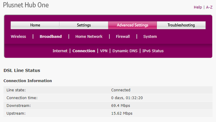

@samdraper Looking at the 'Advanced Diagnostics' and the BB checker, am I correct in thinking you are on the 'Fibre Extra' - 80/20 product? If so, your profile looks horribly wrong as it seems to be limited to the 40/10 speed on download, but on the 80/20 for upload.
Which modem/router do you use? If you can get similar detail as the picture below from it, no need to use the Hub - H1 or H2?

That's correct, I am on Fibre Extra. I use an Archer VR400, I've attached the similar screen from my router. Thanks

Sam, from that last screenshot, I am fairly convinced you have a BT network problem - your DSL uptime suggests you have been having disconnections which should not be happening.
I suggest you report a broadband problem, using the 'report by text' option on this screen:- https://www.plus.net/help/report-a-problem/broadband/
