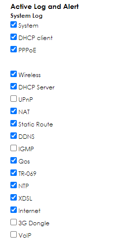

I can get to the logs. I'm not sure what to include or not:
It seems to produce pages of stuff that don't have the same level of detail as the Hub 2 logs, or are repetitive.

Re: Intermittent slowdowns
@hugonebula
I'll let  @jab1  continue to help you with the logs and connection issues,
I'll keep an eye on this topic and contribute by helping with connection settings and reducing bufferbloat.
I'm done for today,  good luck with your hopefully more responsive QoS managed connection !
re post #67
In order to investigate the speed issue, sight of the 'System' and 'PPOE' files may help - again I don't know, as I have no experience of that router, but it is worth a try.
@jab1 wrote:
re post #67
Attached is the whole log. There's only a few PPoE entries, and no System.
