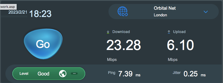

Another small update: speeds have now dropped to the lowest I've ever seen since moving to Plusnet.

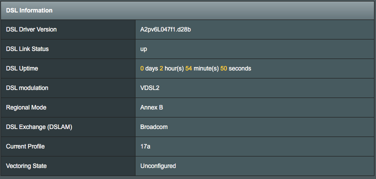

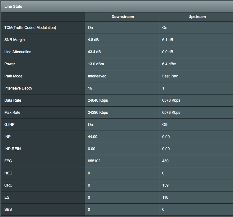

Sure, here's a few grabs of the DSL System Logs.Activity logs I have been posting in this thread as we go along. HTH. Anything specific?
