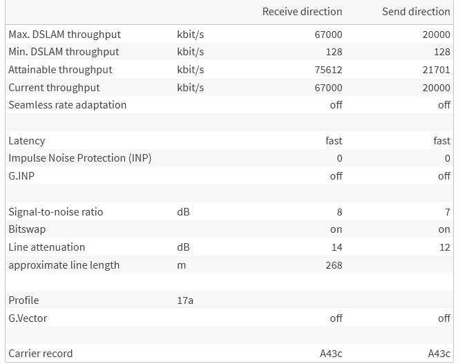

After a number of intermittent connections, I raised a fault ticket. Long story short, an engineer came round and reported no fault on the line (VDSL2 service).
However, even though nothing had changed inside the home, the max down speed was much lower than previously: now 67Mbps rather than the 78Mbps I was getting before. My FritzBox 7390 router reports that the DSLAM is restricting throughput to 67Mbps but max attainable throughput is much higher - see screenshot attached.
Looks to me like while there's no fault on the line, the DSLAM is incorrectly set.
Thoughts?

@mdubash  Looks to me like your line is banded at 67Mbps, ask Plusnet to action a DLM reset which will remove the speed restriction.

It isn't: the line is capable of near 80Mbps, as it ran at that speed for years. Now it's restricted to 67Mbps exactly (so it's very likely to be a settings issue), which my FritzBox clearly shows is lower than the speed the line supports.
What's more, it sets the connection two or three tmes a day, which never used to happen. The advisor I spoke to yesterday said she could there was a fault - but now the automated email says there isn't. There clearly is.
