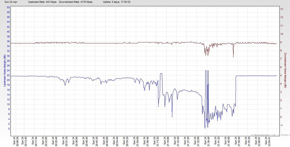

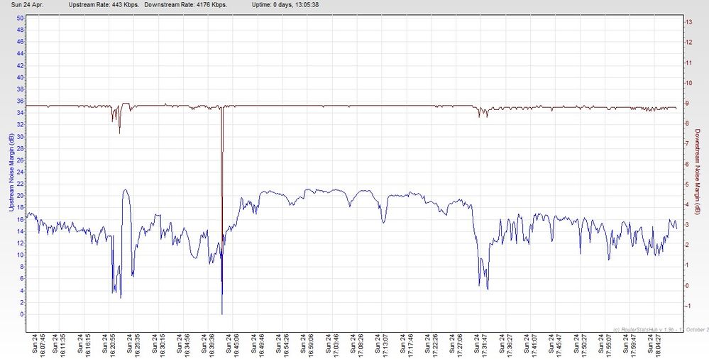

Re: IP Profile speed drop
24-04-2022 11:52 AM
Hi Townman,
Thank you for your offer of help. I have opened the app and entered my router password, see screenshot attached.
Where I need help is what should I be doing next? There are several tabs across the top. Could you please talk me through if I need to input anything, or do I press capture? Sorry, I'm am not very good with this sort of thing.
24-04-2022 1:09 PM
The tab of main interest is the noise tab. If that is not plotting just hit the resume button. Do not be afraid of it - poke around!!
If you can find your way into the detailed settings, set the sample interval to 10 seconds and the plot count to 720. Each graph will cover 2 hours. Graphs will be saved in the capture folder.
That screen shot already points to what needs to be watched. The DS SNRM is higher than expected with a consequent loss of speed. Need to determine why the SNRM is so elevated.

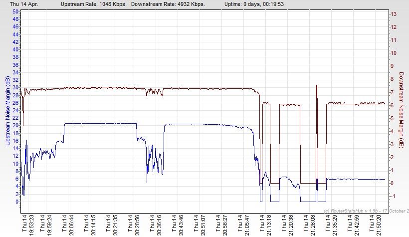

Just attach some of the SNRM graphs here illustrating inconsistency of signal. Try to correlate those times with activity in the household - for example telephone calls (in or out).
For example, here is a live issue I am monitoring...
