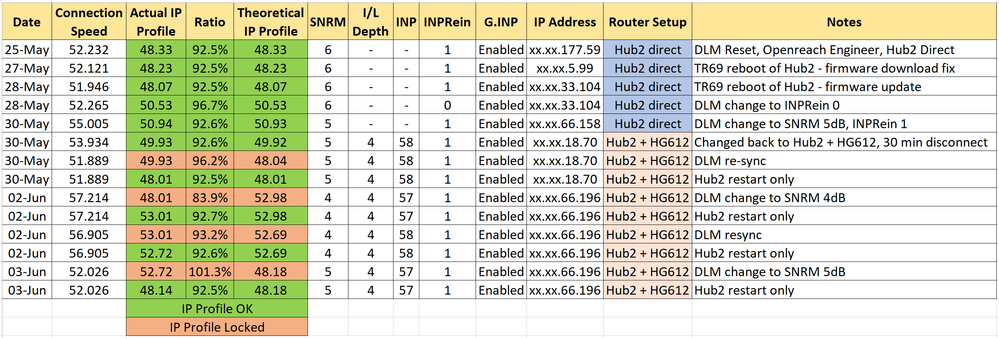

Update following Hub 2 direct dsl connection trial.
Over a few days I kept the Hub2 connected direct via dsl to the master socket, monitoring the IP Profile, until DLM dropped the SNRM to 5dB. At this point I swapped back to connecting through the Hub2 WAN port/HG612, updated table below;
What this has shown is that when the Hub2 is connected direct via the dsl port, the IP profile updates whenever there is a DLM re-sync, but when connected through the WAN port/HG612, it doesn’t. What I discovered however, is that a quick reboot (through the Hub2’s Restart tab), but leaving the HG612/VDSL up, correctly updates the IP Profile. It also updates by a quick Hub2 “Broadband Disconnect” and connect cycle.
So the question is why is there an IP Profile update issue with the Hub2/HG612 setup, when it works fine with the Hub One/HG612? I will avoid getting into possible technical reasoning as I’m not familiar enough with the intricacies of PPP/DSLAM/DLM/bRAS/IP Profile etc., all I can do is show my findings and work around.
I guess that the Hub 2 was only intended, or tested, with direct dsl connections or via the WAN on FTTP setups? It would be good though if this issue could be investigated and fixed, but probably well down the PN priority list, if added to it at all!?
I will attach the Hub2 Technical Log to the fault ticket as I can see that when the dsl port connection is lost, PPP detects it and re-establishes PPP again when dsl is restored. However, there is no PPP activity if the vdsl connection through WAN is lost. This suggests that PPP plays a part in the overall IP Profile update?
So now I know all this, going forward I can stick with the Hub2 / HG612, knowing I just need to restart/reconnect the Hub2 if the IP Profile is not updated. Now I’m nearly back on 3dB SNRM though, everything should settle back down to infrequent DLM interest.
