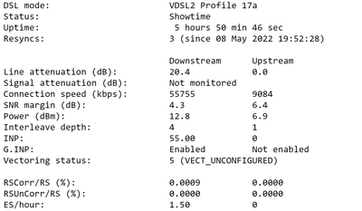

I upgraded to Unlimited Fibre Extra a few days ago and the DLM is doing its "stuff" to lower the SNR margin towards 3db and increase the connection speed, Current line stats below:
Connection StatsConnection Stats

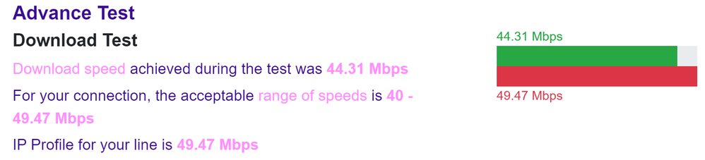

My issue though is that the IP Profile has stopped increasing and is currently stuck at 49.47 Mbps, see below:
IP ProfileIP Profile
Could a member of the PN team please check this for me and reset the IP Profile, thank you.

If you are not on a static IP address, Plusnet's IP profile will have no affect on your data transfer rate.  Regardless of that the IP profile reported here is that of BT Wholesale and TTBOMK Plusnet has not influence over that.
Depending on the level of error recovery (interleaving) on your line, the IP profile could be as low as 91% of the sync speed and then you need to deduct a little on data tests for message over heads.  The stats below indicate that interleaving is being applied to the DS.  Your BT IP profile is probably about right.
If you are on a static IP address, there is a slight possibility that the Plusnet profile is a little behind the curve.

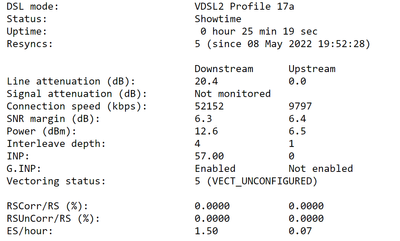

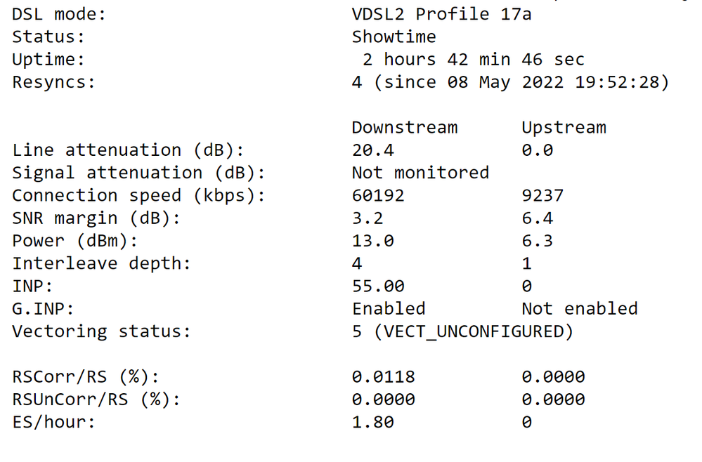

DLM has now completed its change to 3dB SNR margin, achieving a connection speed of 60192 kbps. Unfortunately the IP Profile remains stuck at 49.47 Mbps, now 82% of the connection speed. I have attached the respective screen shots below including my CRC and ES graphs which show zero issues apart from the modem resync itself at about 4AM, showing that the line is handling the 3dB SNR connection very well.
Could a member of PN staff please review how to resolve the stuck IP Profile as discussed earlier, so that I can benefit from the lines full capability. Thank you.

@Gandalf  the line was not banded so what would DLM reset achieve? Was it actually a DLM reset as I thought you couldn't action one unless the line was banded? It hasn't done anything to solve the problem just increased the SNRM to 6.3db so the sync speed has dropped to 52.15Mbps but the IP profile is still stuck, it should be around 47.45Mbps or even less because the line appears to be on G.Inp with retransmission high.

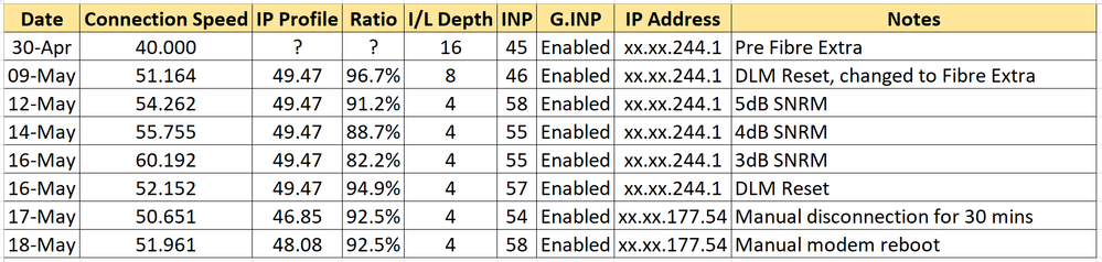

Following a suggestion from the TBB forum, yesterday afternoon I decided to disconnect for 30 minutes (dropped PPPoE, wait 30s, dropped VDSL, wait 30 minutes, re-established VDSL then PPPoE). I also followed this with a quick reboot this morning. I then must have been bored, (or something like that 😜) and put a summary table together of what has been happening:
I will not be manually touching the modem again to avoid upsetting DLM!!!
The 30 minute disconnect seems to of had a positive impact:
a) I've now got a new IP, the old one I'd had for almost 6 months, in fact I was beginning to think the system had stopped renewing them after a period of time.
b) The IP Profile changed to 46.85 and again to 48.08 on the last reboot. Now in my mind this is perhaps a positive sign? I.e. the IP profile has actually changed now, tracking the connection speed at around 92.5%, which seems to make sense?
So I'm beginning to hope, with fingers crossed, that when the SNRM starts to drop, I will start to climb above the dreaded stuck IP Profile of 49.47. Now I know I'm tempting fate, but I wonder if in the next couple of days it will increase to around 50.2 😮, lets see.........
