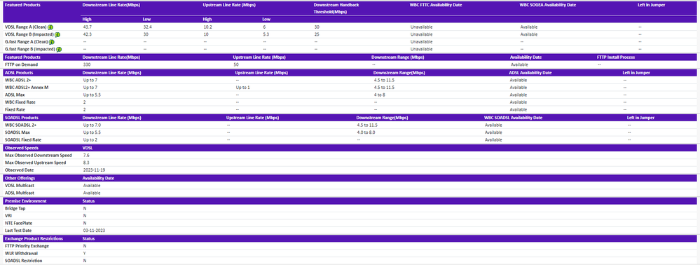

@Don101   to help you clear up what PN speeds you should be getting, could you enter your phone number into the BTW DSL Checker and post the results - hiding your phone number. https://www.broadbandchecker.btwholesale.com/#/ADSL
You have said several times you used to get higher speeds, I and others have said you likely have a fault and should get that sorted to get your speeds back, yet you seem to believe what the nice man from PN says 9Mbps is OK.

Don101
Posts: 17
Thanks: 3
Registered: ‎01-02-2024
Re: Guaranteed Minimum Speed

@Don101 Looking at that rather old report has reminded me to ask, which router are you using, and have you had that speed since November last year?

Mustrum
Posts: 3,704
Thanks: 1,108
Fixes: 81
Registered: ‎13-08-2015
Well done @Don101 .
So that shows you could be getting up to 43Mbps, and that the handback speed is 30Mbps.
It also shows in the Observed speeds, 7.4 and that your upload speed is higher than your download speed.
So the nice man you spoke to should have been able to see this, but either ignored it or is totaly incompetent/lazy.useless/a liar take your choice, but for sure was not doing you proud.
As mentioned earlier, please get a fault reported, don't listen to any bullsh!t so that at the very least you are getting the speeds you are paying for until your contract runs out.
