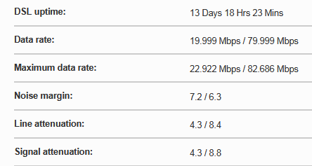

Just wanted to confirm after getting another DLM reset around 2 weeks after the post on the 13th november my speed is back to 80,000kbps down and 20,000 kbps up
thank you again @plusnettony and merry christmas ![]()
Re: GEA test and DLM reset request
a week ago - last edited a week ago
forgot to add this ^^
