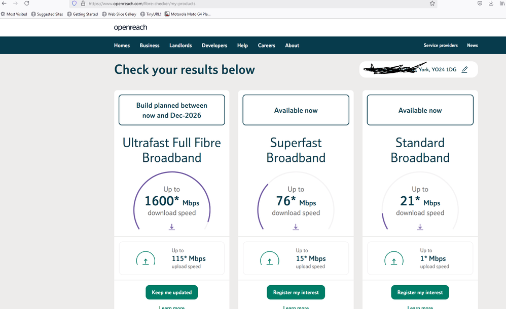

Currently, according to OpenReach,  the even numbers of our street (not us) can get Superfast broadband up to 76Mbps, with a promise of Ultrafast by Dec-2024.
The odd numbers (ie ourselves) are also promised 'up to 76Mbps' with Ultrafast between now & Dec-2026 ...
we actually get 15Mbps.

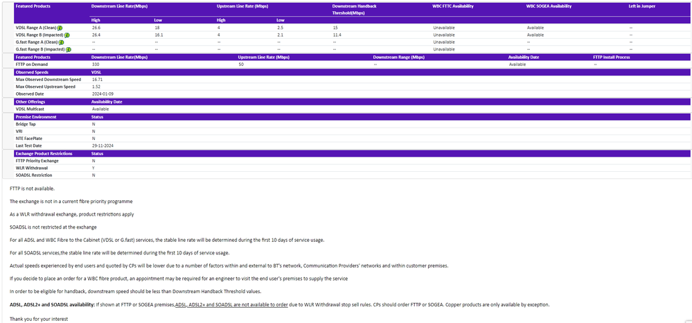

@JohnofYork If the infrastructure is there, then sight of this: https://www.broadbandchecker.btwholesale.com/#/ADSL , (with personal details removed) will give us a better idea. Please include the full page, including the narrative at the bottom.

@JohnofYork It appears from the above that you may have to wait until more work is done to allow you to get FTTP.
I do not understand the 'ultrafast' comment - that actually refers to FTTC/VDSL, which you already have, albeit with a long 'final mile of copper, which is restricting your speed. Out of interest, what are your router stats (assuming you you use a PN Hub)?

Ultrafast is from the OpenReach page for our address/postcode ....

But what is in the boxes at the top of the screen shot that have been cut off?
In the left one I can read “now and Dec 2026” - what is the full text “available sometime between now and December 2026”? That would make all of the other information correct - not yet available but being rolled out during the next 12 months.

'Ultrafast' is is FTTP - Full Fibre, which is apparently being installed in your area. Froom your attenuation figures, FTTC, which you are on, cannot deliver fast speed, due to the long length of copper cabling in your connection, as shown in the attenuation figures.
