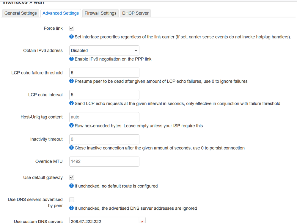

If you are, then check the openwrt kernel log for the WAN ethernet port (eth<n>) status. You may see something like
[9086704.622979] mtk_soc_eth 1e100000.ethernet eth0: Link is Down
[9086717.102934] mtk_soc_eth 1e100000.ethernet eth0: Link is Up - 1Gbps/Full - flow control off
I had a similar problem with a Mediatek chipset based router. It would occasionally 'glitch' and drop the eth port and then immediately recover. Problem was it would cause the pppoe to drop. I fixed it by setting 'force link' on the advanced settings for the WAN interface. In that way it won't drop PPPoE due to a short 'carrier' ( the eth<n interface ) drop but if connection is lost for any length of time then PPPoE will time out due to LCP echo not received.
For info, I have LCP echo threshold set to 6 and LCP echo interval set to 5, so a 30 sec timeout in total

How would I set 'force link'?
It's a check box on the Advanced settings tab for the Wan interface. The same page as the LCP echo settings

Re: Modem random drop-outs
@mdubash  using Luci goto Network->Interfaces, select Edit for the WAN interface, then select the Advanced settings tab. It should look something like this

Thanks - I must be going blind because I can see no such option on the WAN settings page. There's no 'Advanced' tab, nor a 'force link' option.
