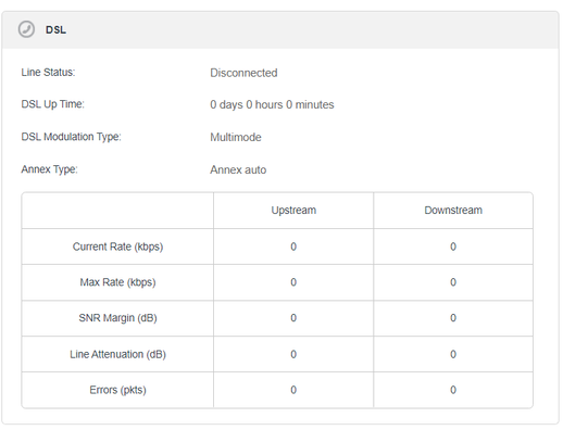

Re: Moved package.
a week ago - last edited a week ago
I've used TP-Link devices for years, so you get to know stuff. This is what it will look like
Clearly in the image there is no active connection
Re: Moved package.
a week ago
So to help @Andy2020 provide us with a screenshot of that, what are the TP-Link menu navigation steps to get there ?

Re: Moved package.
a week ago
Hi, Found it on my router, the DSL part. uploaded snapshot..
Re: Moved package.
It appears that you have two problems !
Those "Current Rate" numbers confirm that you are indeed provisioned on 40/10 Mbps, when you should be on 80/20 Mbps.
As your connection was supposed to be regraded today, if it still looks like that tomorrow, then reboot your router, check those numbers again, and if they are still 9999/40000, then you need to get back to Plusnet support and get them to change the profile from 40/10 to 80/20. While that won't get you to 19999/80000, your line speed should be closer to 12500/52500 Kbps.
Your second problem is that there is something wrong with however you are running your speed tests.
With your router's connection at it is currently showing, a speed test via an ethernet cable should be about 36/9.7 Mbps.
As you are only seeing 18/4 Mbps, you need to find a better way of doing speed tests using an ethernet connected computer and at a time when nobody else is using the connection.
