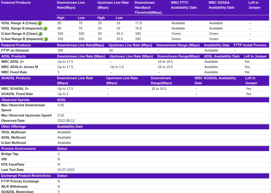

Tests results don't mean much to me, not my area of expertise, but I don't understand why I'm seeing these results.
I have a Q open on this but, before I get back to that, I need to know what I'm talking about, and why this report says there is no problem. There is.
I know there was a reset and I have to wait, but the line seems to be very stable - at a very slow speed.
Over 10 years with PlusNet, at these premises, I always had far better speeds than this so I know this isn't correct. Why is my profile set at this?
Other tests I've run (on this thread) have numbers up to 17.5. I accept I'm not likely to get that but 3.75?

@IanSn That is an abysmal set of figures - absolutely none of them are acceptable.
Sorry to ask for more information, but that in itself doesn't point in a useful direction. Can you pleas post a screen shot of this report (obscuring the phone number), and the Help Desk page from your Hub (hiding your Username) - hopefully that will be sufficient to see what is wrong, but forgive me in advance if I ask for anything else.

The screenshot from that BTW test doesn't show any more than the pdf I posted (except that its now 3.19)
Is this the page you need?

Thanks, Ian. Your router Help Page makes for grim reading. the data rate - both directions, is horrible as are the SNR figures.
This needs further investigation by BT/OR - I suggest you initially report a fault via https://www.plus.net/help/report-a-problem/broadband/ , and report back what they say.
The screenshot is what I wanted, basically just to confirm the fault is within the BT/OR network, and nothing to do with you home one.

From that BTW Availability screen-shot, I would say the problem was not caused by the power-cut(s), although they won't have helped - IIRC the speed they report is obtained from BT test equipment which gets its information from  your connection, not your Hub.
If they call you back, insist on a OR visit - no amount of resets will sort this.

@adamwalker I don't want to teach granny how to suck eggs, but the speed result on the BTW Availability checker shows (to me, at least), that there is a fault/error somewhere outside the OPs environment - unless you know better?
