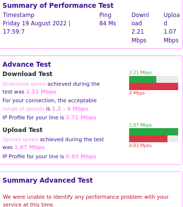

Curious. What exactly was it that was tested to report the problem fixed?
1 - Product name:     Plusnet Router
2 - Serial number:     N7200111B002752
3 - Firmware version:     7.275.17_F2704N_Plusnet
4 - Board version:     F@ST2704N
5 - Mode     ADSL
6 - Uptime:     1 days 12:06:10
7 - Data rate:     994/3071
8 - Maximum data rate:     1224/22440
9 - Noise margin:     8.4/33.1
10 - Line attenuation:     8.0/15.5
12 - Data sent/received:     130.6M/4.0G
20 - Broadband username:
21 - Wi-Fi network/SSID:     PLUSNET-
22 - Wi-Fi connections:     Enable(802.11 b/g/n(up to 144 Mb/s))20 MHz WPS enabled
23 - Wi-Fi security:     WPA2
24 - Wi-Fi channel:     Automatic (Smart Wireless)
25 - Firewall:     Default
Because I just tested it and it aint fixed...
 iansn
Posts: 22,728
Thanks: 7,938
Fixes: 334
Re: Few days of very slow connection ADSL
@IanSn This is clearly not fixed . Your speeds as reported in that BTW test show you are nowhere near your lines capabilities, and the D/S SNR is climbing where it should be falling - for your connection, I would expect to see that figure read ~6dB. The ping time is also excessive, I would again expect it to be considerably lower - possibly in the high teens/low twenties.
PLUSNET need to revisit this - again.
@adamwalker A GEA test result would be interesting.
