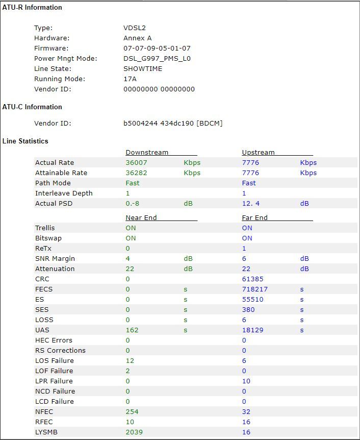

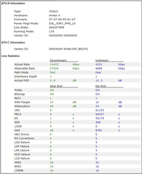

Now I've finished work for the week I can unplug everything and do a quiet line test again, and run the BT diagnostics.
Below are my router stats, though a speed test says that I am getting closer to 7mb rather than 11 and I used to get 33-35mb not 27mb.     Does anything stand out as wrong here?

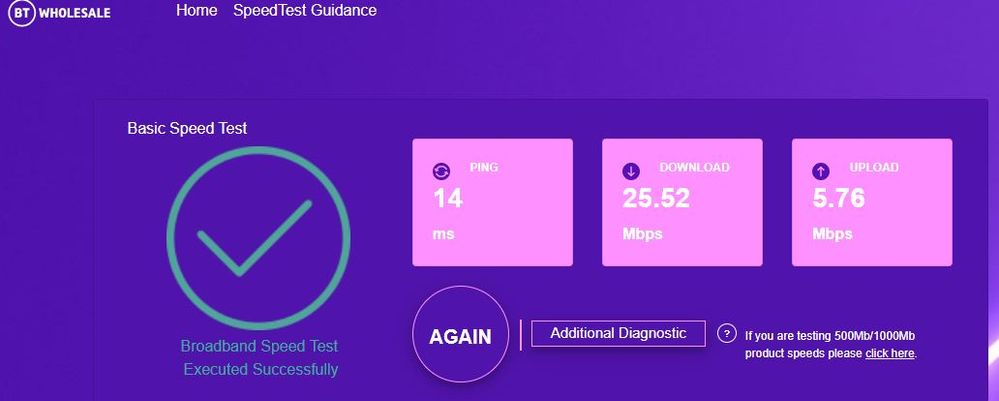

Funny enough after doing a quiet line test 1/2 hour ago (pretty quiet) and reconnecting the router.  Another speedtest has shown a significant jump in speed.  I don't know if you kicked something at your end or not.

There is no point doing data speed tests given those router stats.  Both SNRM and attenuation are grim.
The attenuation figure is a function of line quality and length.  Length cannot be changed, but the repair might improve its quality.  Do you know how close you are to the green cabinet?
The SNRM is the DLM's response to attempt to gain stability at the expense of speed in the presence of the fault.
Nothing more to do here other than wait for the engineer's visit, see what they find and do make sure to ask them to do a DLM reset before they depart, do not settle for the "wait 10 days" mantra.  Otherwise there will be another waiting game.
