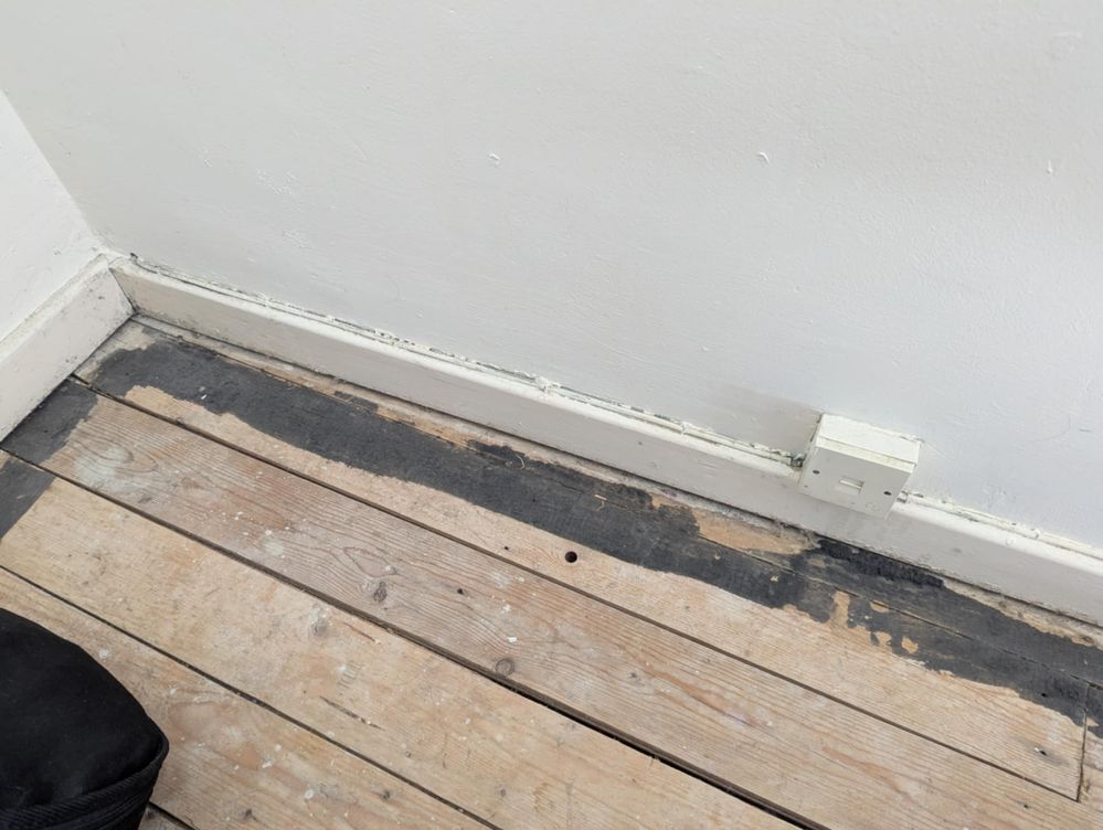

I might be an idiot, because I've just looked behind my office desk and there is an ethernet/modem socket, which from following the wire as far as I can appears to still be connected to *something*, though I can't tell where it eventually goes.
It appears to run through the floor and downstairs and looks to be boxed off down to the floor where I can only guess that it then goes outside and underground, but I have no way to confirm that.

The office socket with the wire running into the corner

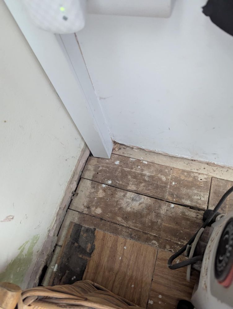

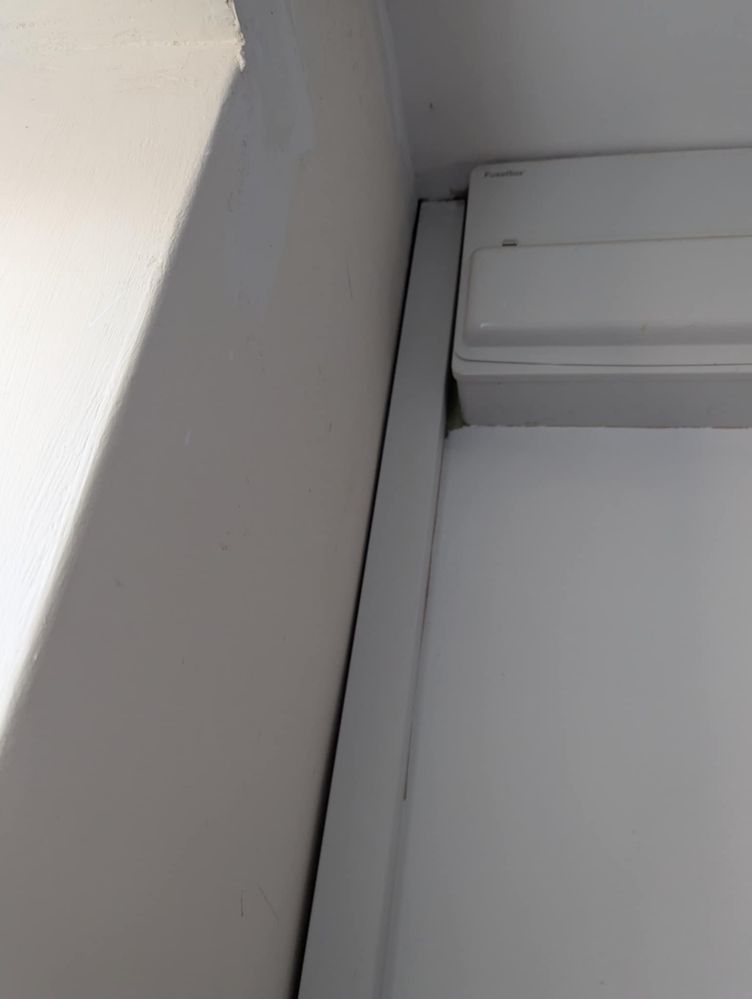

Where I think that wire then comes down into the downstairs
Where I think it then goes down under the floor and back outside, but I can't get the boxing off to be able to tell

The box on the wall may have to come off and or floor boards lifted to allow the OR engineer to work. Either that or they call in a ground works team to dig outside and then being the copper cable in through the external wall.

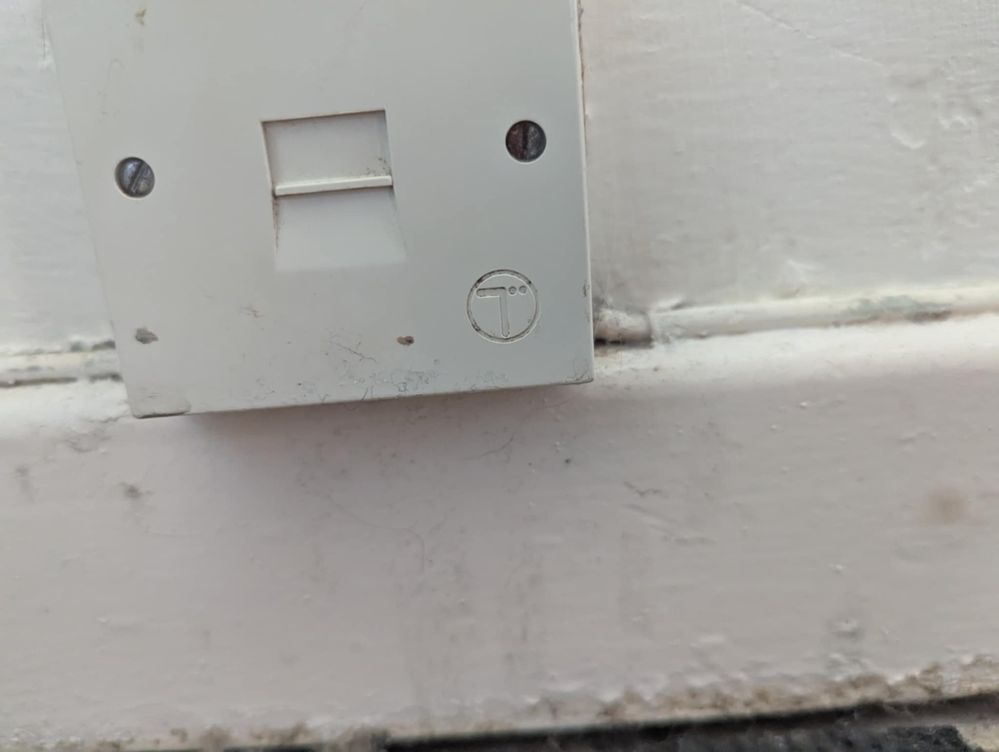

@adtankard1 that socket COULD be a very old master socket , does it have an Openreach logo on it ?
If you've got a old phone, you could check if the socket is connected by plugging a phone in. You MIGHT get a dial tone.
Is that socket in a convenient place for the router to be connected ? note that you will need a mains socket

This is the only symbol on it which I can only assume stands for telephone at a guess.

I think the box needs to come off and the floor board downstairs lifted so you can see what's what and have access for the OR engineer to work.
The MS could go up or downstairs. Either way you appear to have a route for an ethernet cable to run between floors which would allow a Wireless Acces Point to be installed. Or, if the MS is downstairs the upstairs socket could be replaced with an ethernet socket (easy to install - you just need a punch down tool). That way you can plug in any equipment you want upstairs.
