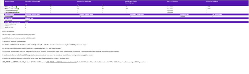

Re: Don't have a modem/ethernet master wall socket, will an engineer install one?
Message contains an image
Based on that you would need to order a Fibre (ie SOGEA) product, which would need a copper line and a master socket.  Firstly you'll need to order that, then you'll need to persuade them to persuade Openreach that you need an engineer visit.  That second bit will be the messy bit!

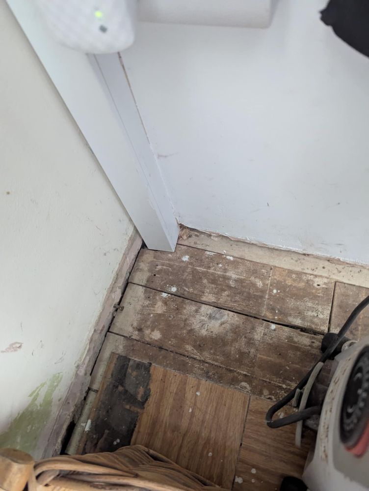

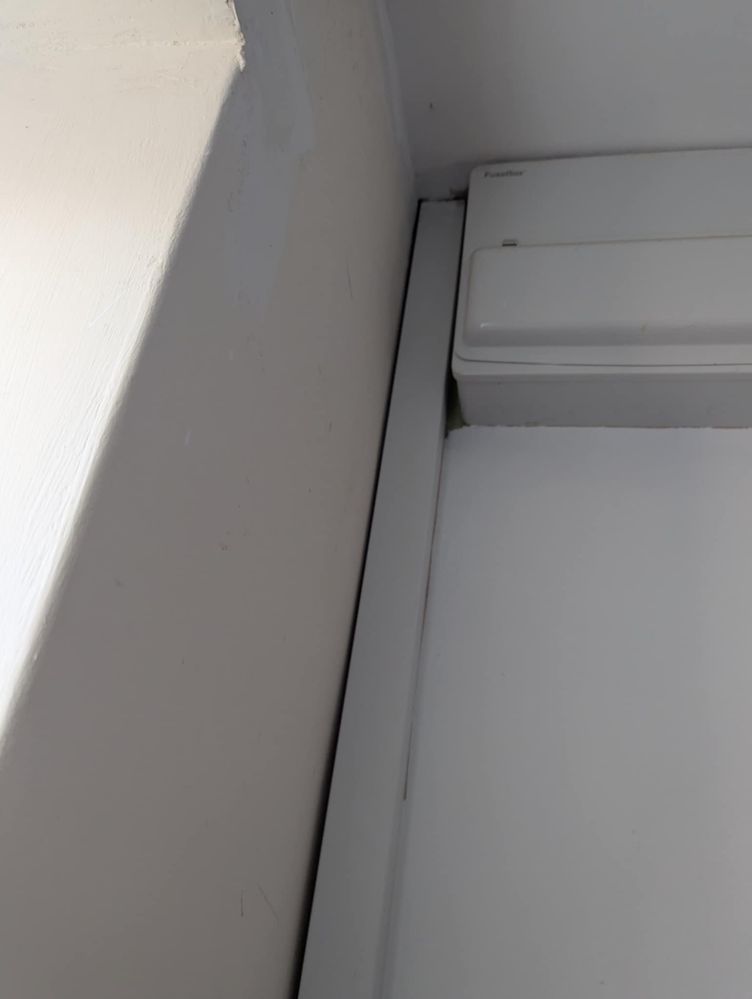

The office socket with the wire running into the cornerThe office socket with the wire running into the cornerWhere I think that wire then comes down into the downstairsWhere I think that wire then comes down into the downstairsWhere I think it then goes down under the floor and back outside, but I can't get the boxing off to be able to tellWhere I think it then goes down under the floor and back outside, but I can't get the boxing off to be able to tell

@adtankard1
Have you given any consideration as to where you would want the Master Socket located?
The box on the wall may have to come off and or floor boards lifted to allow the OR engineer to work. Either that or they call in a ground works team to dig outside and then being the copper cable in through the external wall.

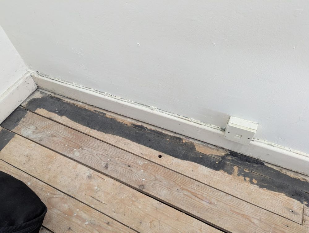

adtankard1
This is the only symbol on it which I can only assume stands for telephone at a guess.r9MrOhP6.jpg
@adtankard1
I think the box needs to come off and the floor board downstairs lifted so you can see what's what and have access for the OR engineer to work.
The MS could go up or downstairs. Either way you appear to have a route for an ethernet cable to run between floors which would allow a Wireless Acces Point to be installed. Or, if the MS is downstairs the upstairs socket could be replaced with an ethernet socket (easy to install - you just need a punch down tool). That way you can plug in any equipment you want upstairs.
You would have a bit of re-decorating to do.
Edit : Just noticed on your latest picture a second cable running out of the box along the wall. Where does this go?
