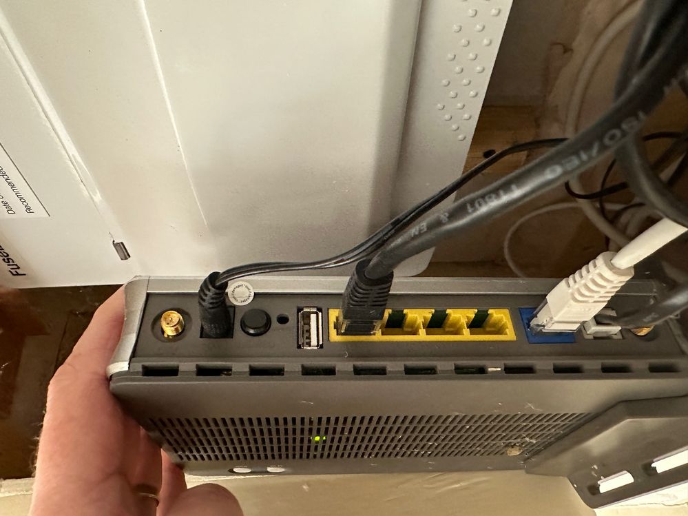

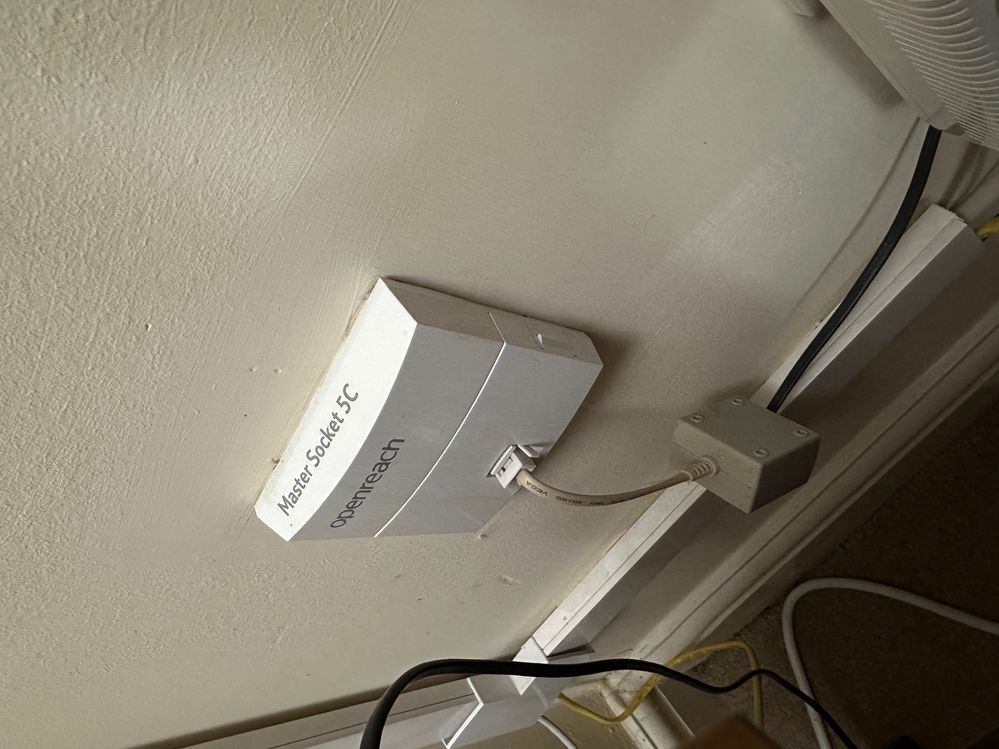

Hi, something must have changed somewhere shown below;
In your house - You said there are no changes.
Eternally with the network - Coincidence by possible.
DLM - I am unsure of the full working but I presume it will manage the sync rate with settings other than the speed profile(banding) like SNR perhaps after the reboot, it thinks the lower sync rate is better.
As your sync rate is lower than the minimum of 36.2Mbps for either of these issues we could do with raising a fault. First, to be sure of no internal issues could you send some pics of the back of the router and phone socket please?

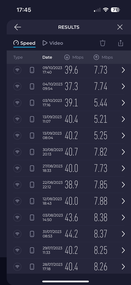

Thanks for your reply. I’ve attached photos of the master socket and router back as requested. I’ve also included screen shots of the xdsl stats page and two pages of speed test history. Clearly I can’t attest to any changes at the exchange or street box, but nothing has changed internally.
Reading the replies, I would query why the line is banded at 40mb, when the Speedtest results show I have previously achieved higher sync speeds. (The Speedtest results are via a iPhone 14 pro over wireless and generally return a figure 10% below the actual sync rate at the router). Having recorded 39/40mb Speedtest results last year, this evidences a true sync speed nearer 44mb.
The xdsl page today shows 34999kb and any attempt to restart the router reverts to this exact same sync speed, so this suggests to me it is being actively managed somewhere to that exact rate.
Prior speedtest resultsPrior speedtest resultsXDSL stats page from routerXDSL stats page from routerSpeedtest showing recent drop in rateSpeedtest showing recent drop in rateRouter imageRouter imageMaster socketMaster socketIn summary, last year I was getting 44mb sync speeds. Now I appear to be limited to 35.9mb. I renewed a contract based on prior performance and I’m no longer getting it, so you can understand the frustration. Thanks again for continued help to resolve this.
