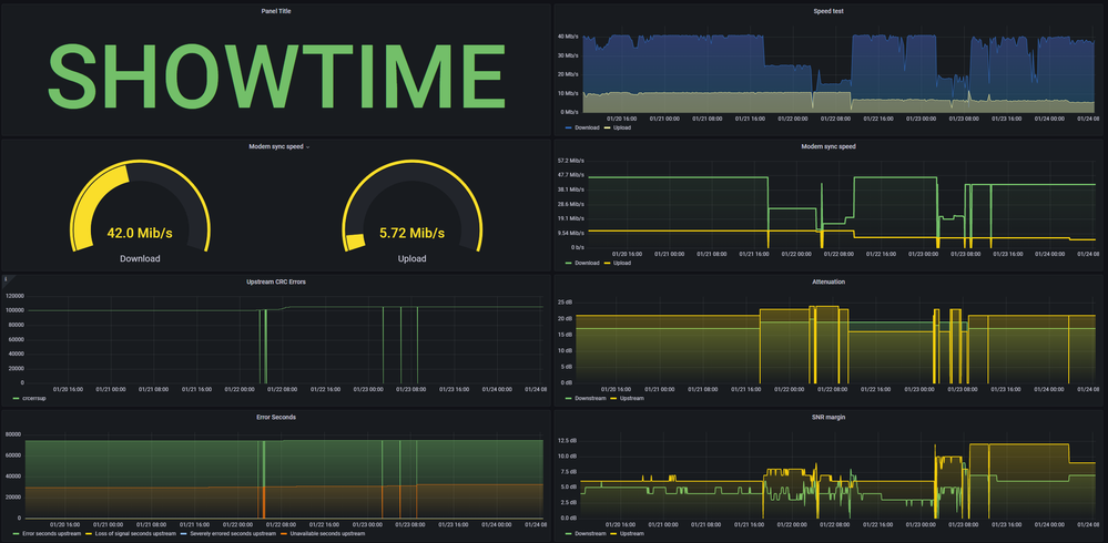

Now ... when I saw the issues before Xmas I started logging the ADSL modem stats and a periodic Ookla speed check, a snapshot of which can be viewed here:
https://snapshots.raintank.io/dashboard/snapshot/3X0197BotdKzkW3FFqKRWiGHuefxnabl

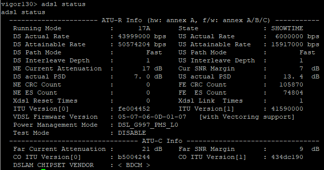

Here is grab of my current modem stats:
Are there any kind staff on here able to advise how I can progress this or do I need to wait until it actually stops working entirely?.... 🙄

@rovingclimber This is FTTC, not ADSL, but from your snapshot in the link, you still have an issue which needs resolving. First question - is your land line phone silent when you carry out a Quiet Line test - dial 17070 from a connected phone and select option 2. After your phone number is confirmed, there should be zero noise, apart from the regular 'Quiet Line Test' announcement - any other noise, report a PHONE fault via: https://www.plus.net/help/report-a-problem/phone/
