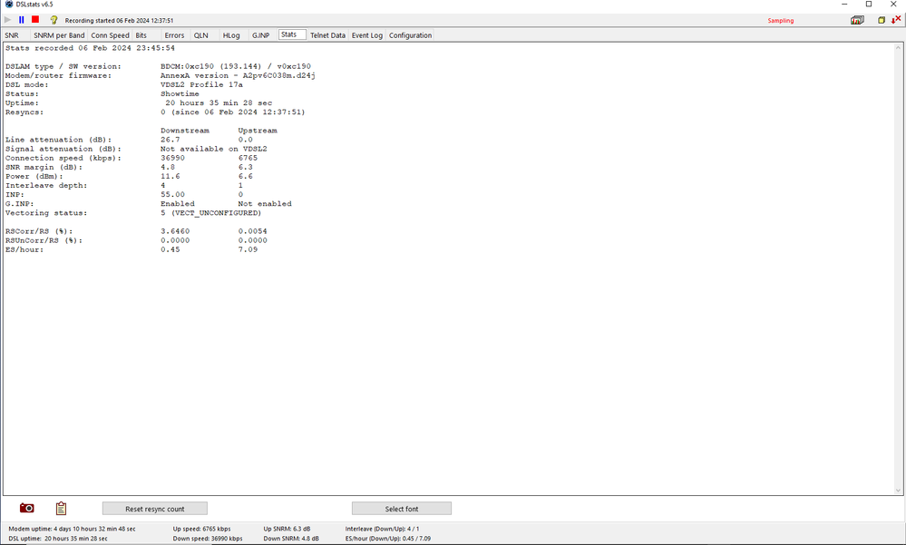

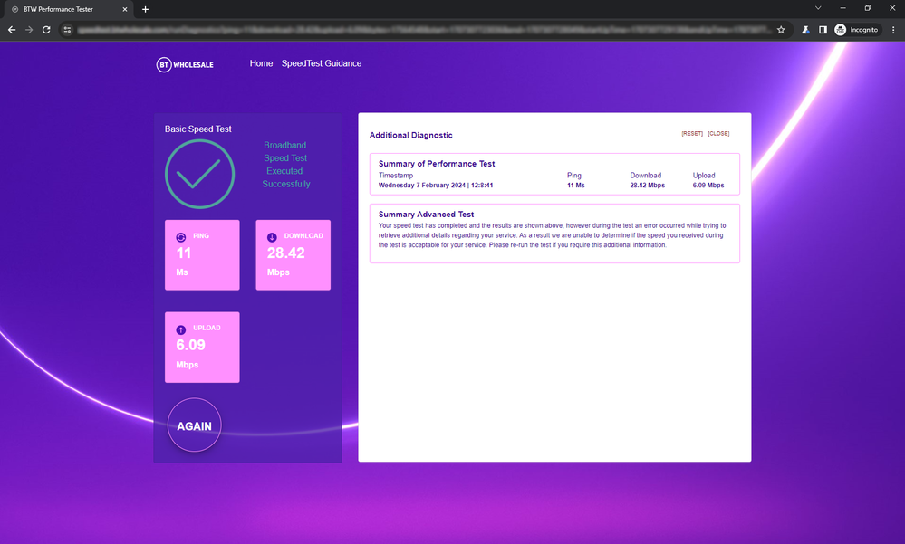

Can someone working at Plusnet check my Connection Profile to ensure it is set to the correct speed for my sync speed,
My line is currently syncing at 36990kbps but any speed tests I run from my computer which is hard wired to my router I only get around 28mbps.
I know this often seems to occur on my line where my Connection Profile doesn't seem to follow my Sync speed and often someone at plusnet has to manually put them back in sync.

I see your  BT Wholesale Broadband Performance Test  failed to display the "IP Profile" values for your connection.
The only way I can get my "IP Profile" numbers is by using the Chromium browser and be in Incognito mode,
and then I can get a result as shown below, on my line currently syncing at 78243Kbps / 19999Kbps -

Re: Connection Profile is it correct for my Sync Speed?
I have tried downloading Chromium and running incognito mode but still getting the same error message see pic below, also tried Chrome, Edge and Firefox but no joy there either.
I have had this problem in the past where my sync speed comes out of sync with my connection profile this normally happens when my line speed increases but my connection profile seems to stay at the old speed, someone from plusnet usually just resets my connection profile and asks me to drop the wan session and then log back in again which normally fixes the issue!
