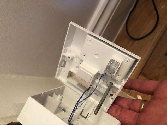

Here are pictures of the socket and the insides. The faceplate also has some electronics but no wires go from the faceplate to the extension. There is an option to attach some wires to the faceplate.

@molszewski thanks for the pictures , it's all clear now.
You have a filtered faceplate. The extension(s) wiring is correctly wired to the back plate. Your extension sockets WILL  be filtered and therefore you are not able to use them to connect the modem.
To be able to use one to connect the modem, you would need to detach the extension wiring from the back plate, and attach it to the unfiltered output on the faceplate. You would then need to use a normal dangly style filter at each extension socket in use. Moving the modem to an extension in this way MAY result in a loss of speed, depending on the length and quality of the extension cabling.
