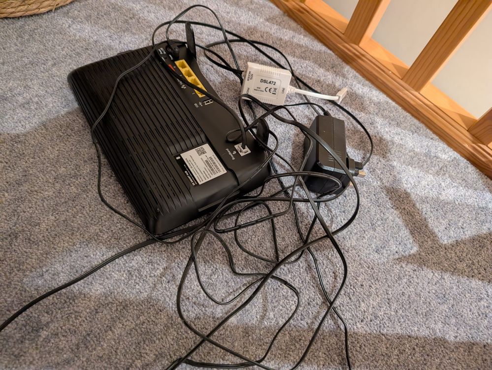

06-03-2025 9:07 PM - edited 06-03-2025 9:08 PM
@Forcibly wrote:
no that picture was taken last week before I had Plusnet.
So when was this photograph taken ? - which has the same filter shown !
Re: Broadband speed capped at 22mb
06-03-2025 9:16 PM
Its not the same filter. The first picture was taken last week. The other phots were all taken at the time i was typing and responding to you. like these 2 new photos are just now.
06-03-2025 9:19 PM
that photo is the only one ive sent that wasnt when ive been with plusnet. It was the only photo I had on my phone at the time when this thread started as I didn't know it was relevant. Every photo after where taken yesterday or just now

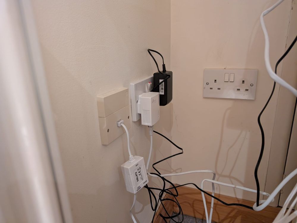

06-03-2025 9:29 PM
It's handy that there's another double mains socket on the adjacent wall.
You could move the powerline adaptor and the PSU to there, as far away from the master socket as possible.

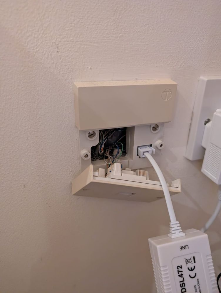

06-03-2025 9:30 PM
I may be totally barking up the wrong tree here but if you're on a SOGEA (internet only) line do you still need the filter - it separates the phone and internet signals?
Try pluging your cable directly into the M/S and see what happens.
06-03-2025 9:33 PM
@outcast yeah i will try that i never thought or knew this powerline adapter could effect it . The reason for it is due to the pc set up being downstairs in an office, and as you know now the master socket is on landing so it was the most coinvent way of doing it.
06-03-2025 9:40 PM
@bmc Its just a single socket M/S , no way for my to plug in an RJ11 connector direct
06-03-2025 9:42 PM - edited 06-03-2025 9:46 PM
You would need a cable with RJ11 and BT431A plugs to do that. (that's what I use in to a single phone socket like yours)
06-03-2025 10:17 PM
In all of your photos, the powerline adaptor has been switched off, so that can't be the root cause of your problems.
However be aware that powerline adaptor's electronics often use the same frequencies as those used by VDSL broadband, so it is best practice to try and keep powerline adaptors away from the master socket, and from the route of the incoming phone line, to minimise the possibility of electronic interference affecting the DSL signals.

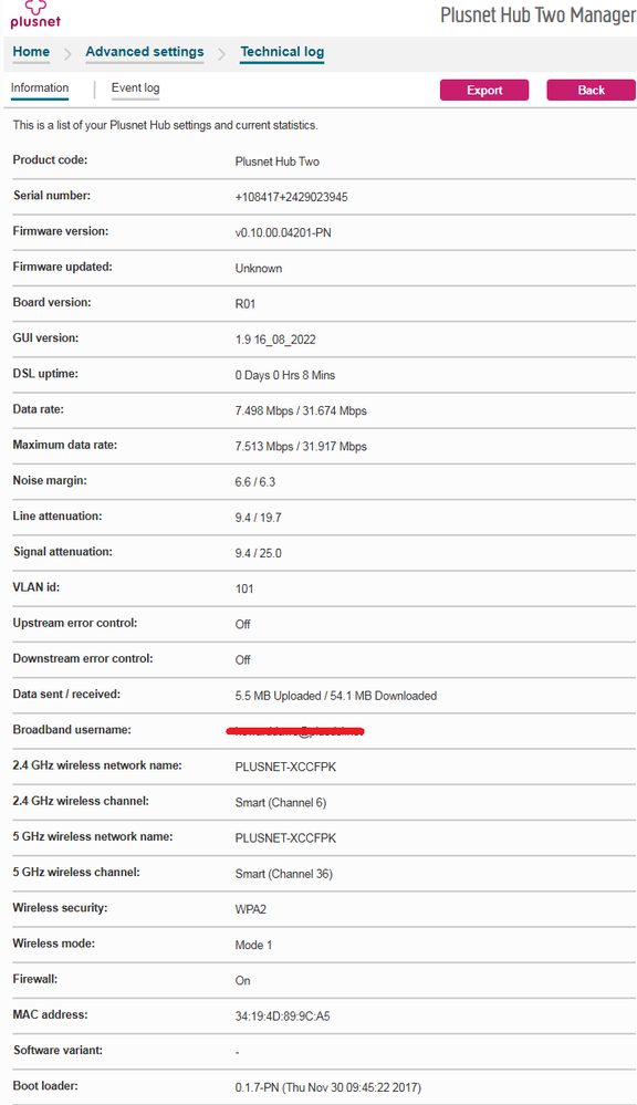

07-03-2025 6:49 AM
@Forcibly Your problem is not resolved by the reset, so you need OR to investigate. Have you moved the plugs to the other par of sockets - although I doubt that is really your problem?
Can you also post your line stats and another error log please?
07-03-2025 9:39 PM
I have moved the plugs to the other socket, I did another test with the test socket and this time with a laptop ethernet direct to router (rather than the power line) and I got to 36mb , since the DLM reset it just stays at 30mb. I havent removed the extension from the master socket as Its not something I can do at this hour. I've attached the line stats and event log but this is after I disconnected due to testing what I stated above.
