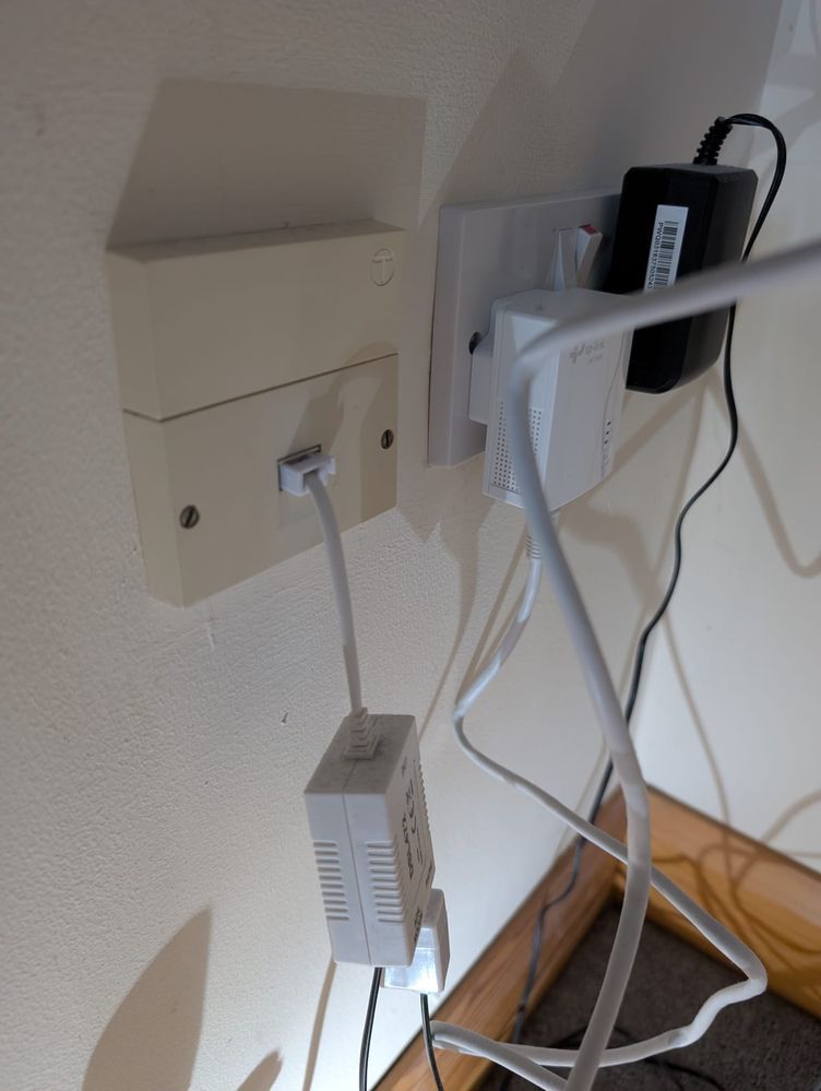

06-03-2025 7:53 AM - edited 06-03-2025 7:53 AM
With your new service from plusnet you will not have a landing phone service, I would advise removing the phone from the ADSL line filter and the extensions wires from the back of the faceplate.
The Line and Signal attenuation reported by the Hub would include any cables connected to the master socket and up to the DSL port.
I would use the DSL cable which came with the Hub two if you are not now.
I also note you are using TP-Link powerline adapters, these can be problematic and introduce noise to the copper connection I'd move it away from the master socket if possible.

Re: Broadband speed capped at 22mb
06-03-2025 8:54 PM
06-03-2025 8:55 PM
Are those the DSL filter and DSL cable that were supplied with the new Plusnet Hub 2 ?
What exactly is hanging out of the ADSL and PHONE sockets on the underside of the filter ?
Might be worth swapping over the TP-Link adaptor and PSU plug, so that the TP-Link is further away from the phone line.
