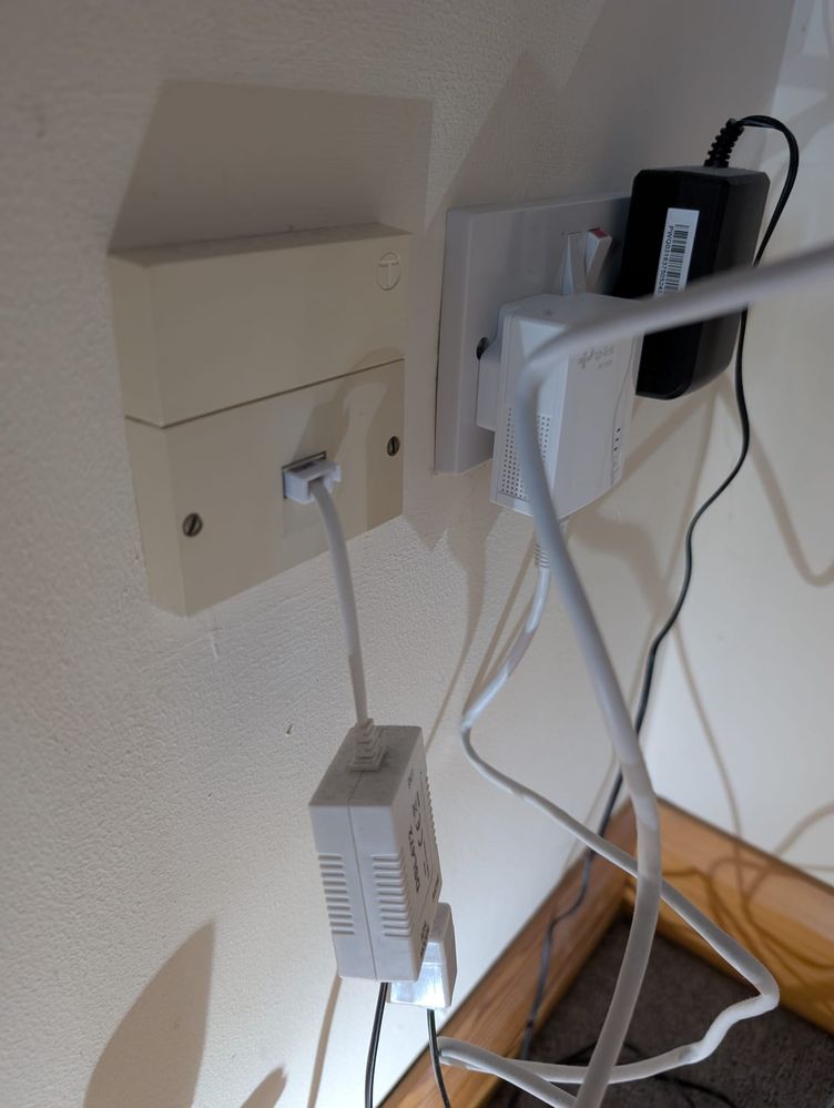

@Forcibly Where does the telephone line enter your home? Can you post a clear photo of this 'master socket'?
Forcibly
Posts: 30
Registered: ‎05-03-2025
Re: Broadband speed capped at 22mb
f272b5cb-0ef0-465a-be88-164925f034af.jpgThe property is a bungalow / dormer . Line comes in at the front of the property into our spare room. There's no socket in there at all so I guess it goes under the floor onto the landing where the socket is.

EDIT - that is a master socket.

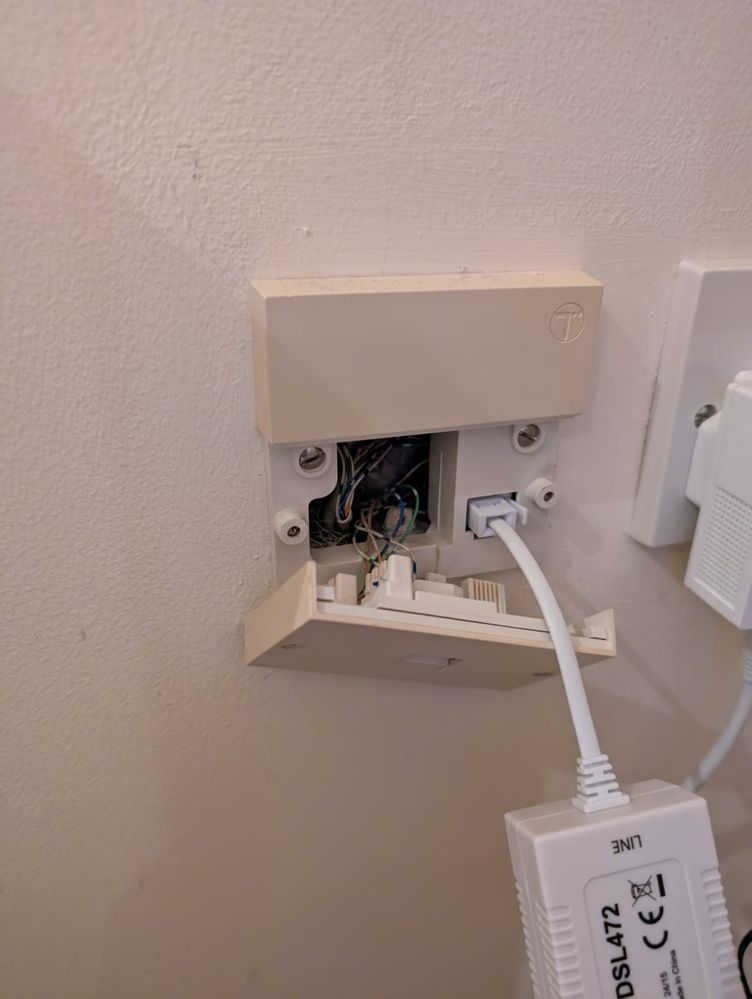

@Forcibly
If you unplug the filter and unscrew the faceplate before carefully removing it is there a test socket behind it?
If there is, plug the filter into this and run tests again.

@bmc As that is a master socket, there will be a test socket.
