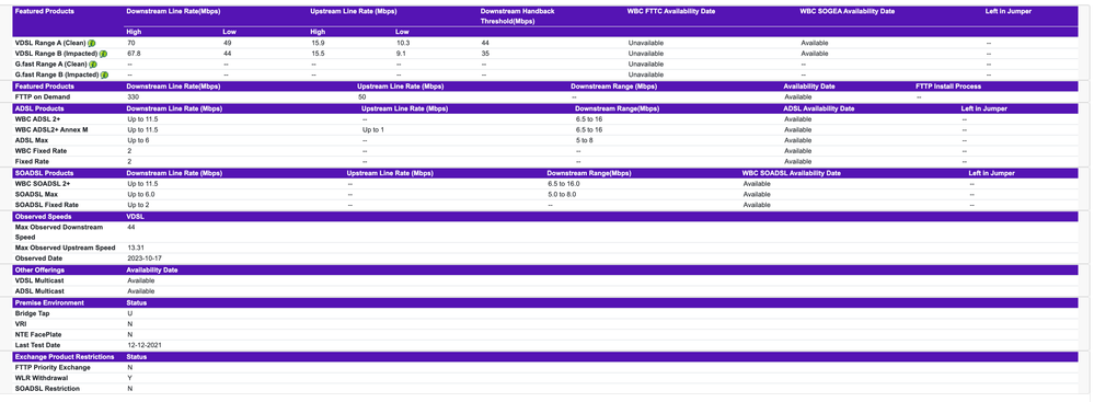

I first moved into my property a few years ago and looking at back at older speed tests I did I was getting around 50 - 55 Mbps.
However I think it has been getting a bit slower over that time, I can't quite pinpoint the date but doing a speedtest now I am looking at around 40 - 40 Mbps,
I have attached my BT Wholesale checker results.
I am just wondering if this is something I should get in touch with Plusnet about? Or am I just a bit unlucky?! I think I am a bit away from being about to get FTTP so it's a tad frustrating.

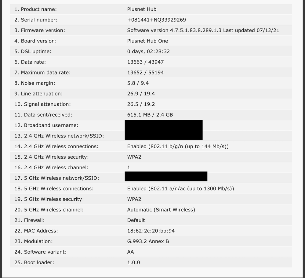

From your helpful instructions I have pulled the details from the Hub.

@stephenheron I did say 'ignoring the two tests you have already done' 😉 - the instructions I posted are a direct copy and paste  of a standard 'help sheet'.
From your Technical log page, I am suspecting xDSL drops caused by Openreach equipment issues  - to confirm, can you please export the complete log and post the result.

Quite useful actually as I can see that back in April I was syncing at "48941Kbps", which is around what I remember it being at for ages, then since then it's dropped down to what I am seeing more recently, it's not a massive drop looking at it! Just a bit strange as I haven't changed anything on my end!

Thanks for that, @stephenheron - it proves what I suspected - there is something going on which has caused your downstream SNR to rise, consequently depressing your speed. As you don't have a phone to test for noise, unfortunately, I suggest as a first step that you report a broadband fault using this link: https://www.plus.net/help/report-a-problem/broadband/
