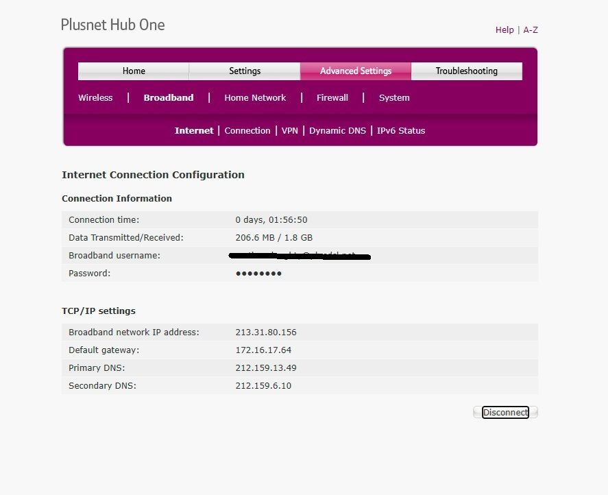

If you take screenshot of the Hubs pages as below, we should see all the data I'm after:

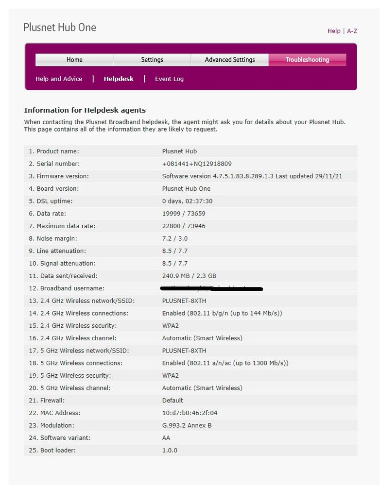

If you looking for Noise Margin, Line and Signal attenuation you mean this page >Troubleshooting >Helpdesk

@Dan_the_Van Thanks - I was just going to ask for that, too.
@MathewDoughty I don't think there is anything actually wrong with you connection, but you appear to be doing a lot of uploading, which will hog your bandwidth. Do you have something like OneDrive running permanently?

@MathewDoughty I can see nothing wrong with the connection in any of those shots. You must be sat on top of the cab with those figures, so, unless someone else can think of something, I would be suspecting something in your home environment.
There is in anything of that data that points, to me, to any external issue that Plusnet could address.

I'm sort of wondering with those Line and Signal Attenuation figures 8.5 / 7.7 and Noise margin 7.2 / 3 that the downstream sync speed would be nearer to 80mpbs than it is currently showing. Maximum data rate 20800 / 73946
Might be worth using the broadband fault bot to check there are any underlying issues
https://www.plus.net/help/report-a-problem/broadband/ (warning it might report no issues)
If finds no issues it might point you to check your wifi.
