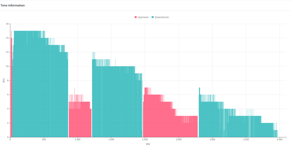

Is it possible to get to the Plusnet Hub 2's VDSL tone BINs, either via web interface, telnet, DSLstats, or RouterStats ?
I'm wondering if @JHarland has a big hole in the tone BIN spectrum that might give a clue to what might be interfering ?
This is what a good VDSL tone BIN graph should look like -
