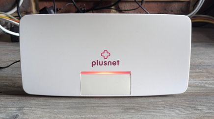

Shame cant switch off the hub 1 lights, but its a much cheaper solution currently that powerline repeaters or a mesh system, which is likely overkill for my needs.

If you are careful it is possible with a knife blade to peel off the cover of the Hub One lights and cover with some dark tape. You should be able to stick the cover back on.

If the lights on the Hub1 bother you have a look on Amazon for "LightDims" - a neater solution than just taping over the lights.

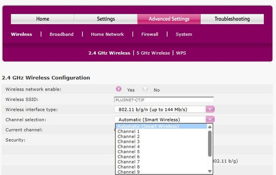

How did you split the channels. I just left channel selection at auto

@penfold
You change the channel here, showing 2.4 GHz
Select an unused channel of the Hub two, using either 1, 6 or 11 to prevent overlap with adjacent wireless stations.

Thanks. Did you leave hub2 at auto and just manual select on hub 1?Huh

I've just checked, I made Hub 2 Ch 1 and the WAP I use Ch 11 as at the time they were the least used where I live.
