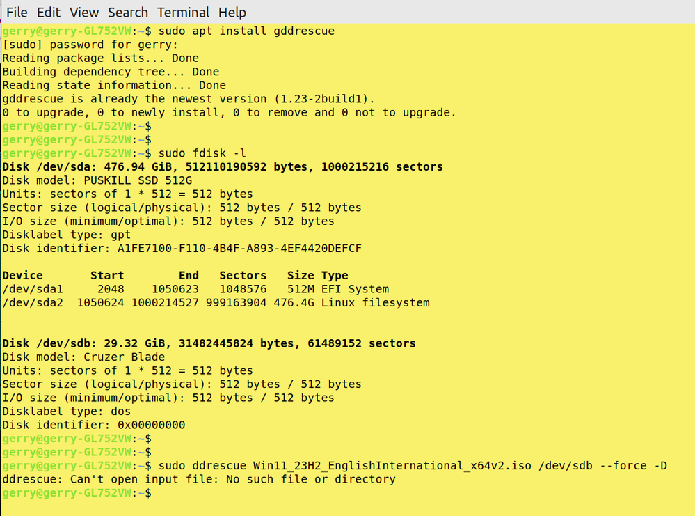

For the past couple of days, I have been trying with no success, to make a bootable windows 11 usb ( Also tried to make a bootable DVD - but Win 11 is too big for the DVD ! ) ( shame cos Win 10 worked fine on that)
so... I have used the following
Linux Mint 21.3 virginia o.s.
USB Stick formatter - followed by USB Image Writer
VENTOY
WoeUSB-ng
And other USB writing software
RUFUS, UNetbootin Universal USB installer & Balena Etcher.
some of the last one`s reported that WIndows .iso needs special softwares and suggested Rufus and Ventoy and WoeUSB
WoeUSB-ng did (eventually after a couple of hours waiting time ) make a usb install, but when I plugged it in to my 2nd laptop, to install it, it reported that there was no bootable media !. ( VENTOY did the same thing ) .
Looking on line for other methods, I also tried ddrescue. via the Terminal command lines.
from this linky  .......    https://linuxconfig.org/how-to-create-bootable-ms-windows-usb-under-linux

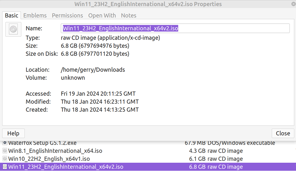

Don`t understand the  "Can`t open input file : No such file or directory"...  cos it is a copy and paste from this
Where am I going wrong?

Re: Windows 11 bootable usb problems
Does ddrescue need the full / relative path to the source file?
You appeared to be in your home directory to issue the command, but the source appears to be in "~/Downloads/".
Regards,
Alistair

@archerry  Erm ......
Possibly,.... but It is not clear from the "instructable" page on that bit.... so if you could give me the correct(?) "relative path" to get the "source file".. then that might be the way forward.
ThanksWink

@shutter
I usually use the full path within such commands, to remove potential errors about which directory I am currently in.
Looks like the full path should be "/home/gerry/Downloads/Win11_23H2_EnglishInternational_x64v2.iso"
Regards,
Alistair
@archerry  OK... thanks for that.... will give it a go later on, as busy doing other stuff now.  Will report back ! Wink
@Dan_the_Van   Yes, I have used Balena Etcher before for this kind of stuff...but for some reason it didn`t work for me this time.( can`t remember why,.... cos I used so many different one`s ! ) . Thanks Wink
@archerry  & @TheRoadCrew  & @Dan_the_Van
update... no success !.  with ddrescue.  I did cd Downloads, and then continued, it took 2.5 hrs to finish.. !.. when I put the usb  on Windows 10 laptop. to check ... it showed the files and folders, as expected. ( originally)  but on a subsequent occasion it said "unrecognisable file format " !
As for using WoeUSB... again 2.5 hours of time wasted... !   it did not complete properly , the final part of installing the GRUB files just kept on running, eventually, freezing the laptop, so I had to do a "hard reboot". which. presumably messed up the USB finalizing...
so I have now given up on this episode, and confining my self to Windows 10 for experience..( can`t be that different from Win 11) .
