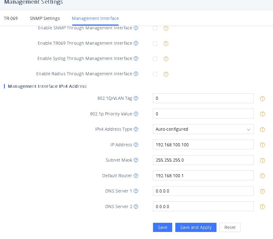

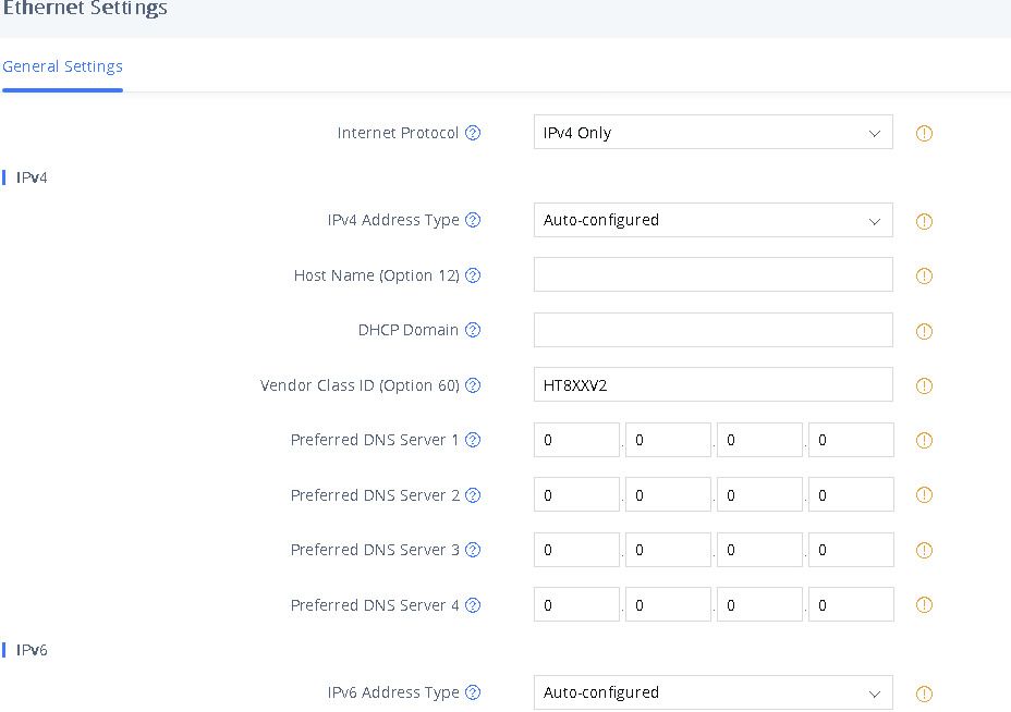

@Dan_the_Van On the HT802v2 side, there are two places that I can see which refer to changing to a statically configured IP but I am not sure which to change and what the parameters should be.
Under Network Settings this is how things look at present...
If I choose Statically Configured in the drop down then this is what I see but I don't know what to fill out. By the way the current IP address is 192.168.1.125...
Under Management Settings this is what I see...

I think I have it working by setting it on the Grandstream. Google Gemini told me to use 192.168.1.254 for DNS Server 1 and 8.8.4.4 for DNS Server 2. Hopefully this is OK. The VOIP phone seems to be working still.

The important network settings for a manual setup
IP Address - 192.168.1.? (1 to 73)
Network Mask - 255.255.255.0
Default gateway - 192.168.1.254 (this is the routers IP Address)
DNS Server - 192.168.1.254 (the hub is a DNS server or you can use choose your own)
DHCP would populate them automatically.
