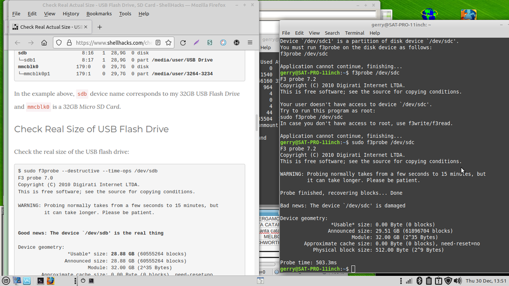

@billnotben  Thanks for the heads up on the fake card software.... I did a "kinda" search on google to see if there was a Linux equivalent... and apparently there is... ( called     f3   ) ( which you have to use on the "command line /Terminal screen )
so I followed the instructions on this page ...
https://www.shellhacks.com/check-real-actual-size-usb-flash-drive-sd-card/
and here is the result .
gerry@SAT-PRO-11inch:~$ sudo apt install f3
[sudo] password for gerry:
Reading package lists... Done
Building dependency tree
Reading state information... Done
f3 is already the newest version (7.2-1).
0 to upgrade, 0 to newly install, 0 to remove and 0 not to upgrade.
gerry@SAT-PRO-11inch:~$ lsblk
NAME   MAJ:MIN RM   SIZE RO TYPE MOUNTPOINT
sda      8:0    0 465.8G  0 disk
├─sda1   8:1    0   512M  0 part /media/gerry/F046-8847
├─sda2   8:2    0   513M  0 part
├─sda3   8:3    0   513M  0 part /boot/efi
├─sda4   8:4    0     1K  0 part
└─sda5   8:5    0 464.3G  0 part /
sdb      8:16   1  29.5G  0 disk
└─sdb1   8:17   1  29.5G  0 part /media/gerry/9016-4EF8
gerry@SAT-PRO-11inch:~$ sudo f3probe --destructive --time-ops /dev/sdb
F3 probe 7.2
Copyright (C) 2010 Digirati Internet LTDA.
This is free software; see the source for copying conditions.
WARNING: Probing normally takes from a few seconds to 15 minutes, but
         it can take longer. Please be patient.
Bad news: The device `/dev/sdb' is damaged
Device geometry:
             *Usable* size: 0.00 Byte (0 blocks)
            Announced size: 29.51 GB (61896704 blocks)
                    Module: 32.00 GB (2^35 Bytes)
    Approximate cache size: 0.00 Byte (0 blocks), need-reset=no
       Physical block size: 512.00 Byte (2^9 Bytes)
Probe time: 292.7ms
 Operation: total time / count = avg time
      Read: 232.7ms / 2049 = 113us
     Write: 57.0ms / 2049 = 27us
     Reset: 0us / 0 = 0us
going to investigate further..... maybe there is a "fix" for it....

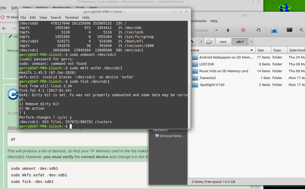

@shutter From a terminal try the following:
df
This will produce a list of devices, so find your TF Memory card in the list making a note of it. The remainder of this will assume it to be /dev/sdb1 However, you must verify the correct device and change it in the following commands:
sudo umount /dev/sdb1
sudo mkfs.exfat /dev/sdb1
sudo fsck /dev/sdb1
The fsck command should say there are 0 files meaning the format was successful. Once you've done this pull the card out and reinsert it to have it auto mounted.

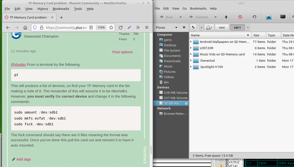

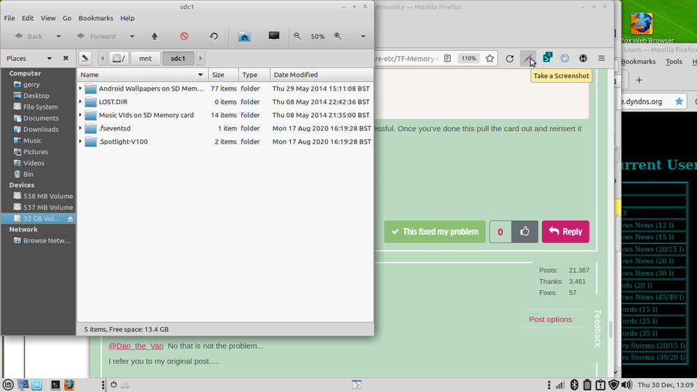

Registered: ‎06-11-2007
Re: TF Memory Card problem
@Mook   Thanks for your input..... the card was actually sdc1... and here it is on the initial insertion.....before carrying out your terminal work.
now showing the results of the terminal work....
And,...... Finally...... ( after re-insertion ............ )

OK... re-done it ..... here is the result
and then i did the f3 command lines again....
