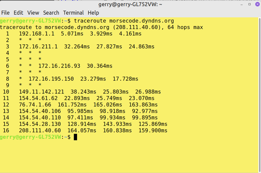

Re: Speed Tests
OK... so here is the first traceroute morsecode.dyndns.org    WITH THE VPN RUNNING ON PN SITE
Here is traceroute morsecode.dyndns.org    WITHOUT THE VPN...

Re: Speed Tests
Hmm - I'll have to think about that.  They look to be almost identical, which I wasn't expecting... it looks like the trace route didn't actually go over the VPN ... ?   Not sure I know enough to comment about that, as I said will have a think....

From what I can see is Urban VPN is a browser extension so it would only hide the IP address for the browser being used.
So testing on a ubuntu mint install I have two browsers one Chrome with urban VPN installed and Firefox with no extensions
With the VPN extension running, 'what's my IP address' shows
Chrome - VPN server IP address and location.
Firefox - my public IP Address and location.
From my research urban VPN does not have a version with support for any variant of Linux.

Re: Speed Tests
@greygit1   The traceroute isn't going via the VPN because as @TheRoadCrew pointed out the VPN runs from within the Firefox browser, so I believe the VPN is only used when you are in/using the browser - anything done outside the browser doesn't go through the VPN I guess.   When @shutter ran the Speed Test with Ookla I believe he would have done it from within the browser and hence could use the VPN.
The other thing I read from a random web site was that the connection over VPN can in some circumstance be shorter and better performing, depending on where you are, where the VPN servers are, where the Speed Test servers are and how they are interconnected... I had hoped we could see some of that with the traceroute.
The other things that can impact the speed test would be encryption, compression, packet sizes, window sizes, processing speeds of any servers involved and the use of IPv4 or IPv6...  but we would need a lot more knowledge of the network and network traces to try to figure out what is going on here.
