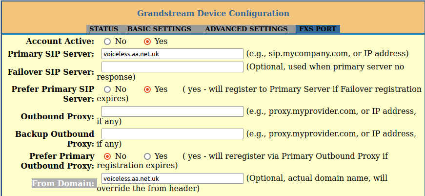

I had an issue very similar to this and, although I'm using the HT801, I thought it worth mentioning just in case.  On the FXS PORT page there is a box for the Primary SIP Server which A&A indicates should be voiceless.aa.net.uk followed by boxes for Proxy Servers (I left these blank) but just after these is a box for From Domain which the comment after it states is optional.  It wasn't for me.  Hopefully, this screenshot will render in a readable manner.  YMMV but it worked for me 😀Screenshot from 2023-06-25 17-42-10.png

I should add that as soon as that 'optional' value was applied, the status page changed from Not Registered to Registered and the attached phone could receive calls.

I entered voiceless.aa.net.uk in the From Domain box, clicked Apply and rebooted. I still couldn't call the landline and as it was getting late I gave up. As my Smart meter IHD was was acting strangely I turned off a lot of things including the HT812 and went to bed.
The next day I thought I would give it another try and powered up the HT812. Without logging on I gave it a quick test and I could make and receive calls.
