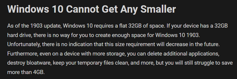

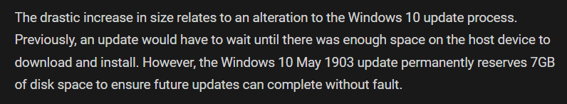

@jab1 they are I think mate, I think it just has a ssd chip. Also came across some other things that might have a bearing.
Screenshot 2023-06-03 182243.pngScreenshot 2023-06-03 182407.pngScreenshot 2023-06-03 182608.png
Perhaps I'm now stuck with what I've got with no way of turning back if there's issues. Don't know if one of the updates destroyed the recovery partition.

Just to add, the main reason I was trying to reset was I'm down to my last 7gig of space, which is adequate to be fair as I also have a 64gig card inserted for data as drive D.
2Gigs of the C drive though appeared to be tied up in windows updates, I've tried many times to delete to no avail so I'm wondering if this space is maybe reserved for future updates now negating my previous comments on having to install updates from a usb stick through lack of space.
Just thought resetting to original would perhaps get me back down to the 16gig used space I had when I first bought it.
