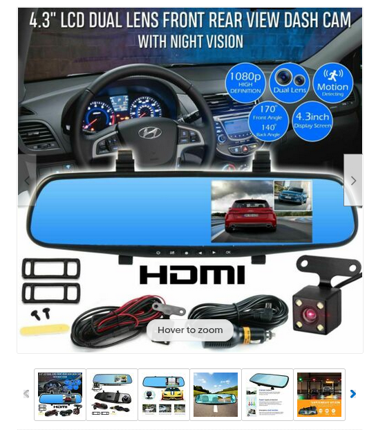

Just fitted one of these, after many years of accident free motoring...
Reasonably straight forward .... but the extra red wire had me wondering for a while, until I watched a video on youtube on how  to fit !...( the extra red wire is for those people who need a "reversing camera" to assist them when reversing  !... it can be ignored, if you are competent to reverse without a camera view !... make sure you insulate the end of the wire (just for safety) before tucking it away behind a panel, during the final tidy up of wiring.
OK... so ... it works,.. and works well... however, the instruction booklet is written in size 2.5 font.. and despite photographing it, and enlarging it for printing out on A4.. it still does not actually cover the following questions.
1. does the system require it to be plugged in to the cigarette lighter socket 24/7 to maintain the date and time settings. or can it be unplugged at the end of the journey, and plugged in at start of next journey?
2. will leaving it plugged in drain the car battery over a period of a couple of days, when car not in use.
3. Is it possible to disable the "view" on the mirror, when actually driving along ? as on a test drive around the block, I found it a bit distracting.
4. how long recording time on a  16GB TF card ?
Any tips or advice welcome.

Just been out in the car for an hour's run-out to Lake Vyrnwy and back... checking the footage.. on a 16GB card. there are 18 short vids from the forward looking camera... and 18 from the rear looking camera.
The 18 vids are all 3 minute long segments... making the total time  of recording 54 minutes, before it starts to re-write over the earliest vid, I suppose...
Front camera looks like i am a terrible driver... speeding up. slowing down, and some  jerky driving speed bits too.....  ( occasionally, and for only a second or two,.... like those fast forward timelapse sections  used on TV progs, where people are walking around normally, then the do a quick jerky run for a couple of secs and back to normal) ..
Er.... no... that's not how I drive.... ! !
.. rear camera looks like I am driving on the wrong side of the road... steady speed no jerkiness ... Have checked the cam by having it switched on, and going to the rear of the car... and looking into the rear window, to the screen on the mirror, and it shows my face the right way up.. so the cam seems to be in the right position... ...I wonder if i should try and invert it,  just to check to make sure the cam shows me on the correct side of the road  ?????

Update  ...
The Front Camera......
  been on a couple of runs out, and checking on the videos on return... the "jerky" recording seems to have disappeared from the front camera... That may be due to the fact that the first recordings were made on a 16GB card.... and subsequent recordings on a 32GB card..... but I can't see that the card size would make "that" much difference, or cause jerkiness in the recording.
The rear camera....
is still recording a MIRROR IMAGE...
which shows me driving on the "wrong side" of the road, and vehicles coming up behind, ( following me ) are recorded with their registration plate in "mirror image" also
Is this "normal"  ? ?
If so... seems a bit daft....  but..... is there any software that can re-record the video in a "mirror image" to produce the correct aspect. i.e. driving on the left side of the road !   ? ? ? ?
I have contacted the seller, regarding the jerky and mirror image, and they will refund me in full on receipt of the item when i return it.....
Problem is... do I then order the same type from another supplier.... will it have the same "fault"  ?   seems strange that there are so many suppliers, and all showing a lot of sales, but none seem to be showing this fault in their feedback sections...
