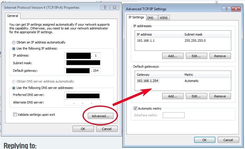

You probably can have two on the same network, just not on the same connection to the ISP,
How you'd go about using both is probably a minor task - just set the default gateway in your TCP/IP properties to the preferred router. If you hit the advanced button you can set multiple gateways:
screenshot_915
Note that I've no real life experience of doing this, i'm just talking theoretically. Windows also allows you to specify multiple dns servers but that doesn't work well - if it doesn't find a record on one server it doesn't bother asking the others. The multiple gateway option may be just as flaky.

@adrianscotter wrote:
The person said they had a telephone socket upstairs so no, you cannot plug in a 2nd router.  Unless you want to cable with CAT5 or CAT6 network cable
Edit: And I meant to say, the 2nd router would need a WAN2 connection or be a cable type router.
Yes you can use two routers on the same network, you just need to specify which gateway your device will use. If you want both supported then windows may not handle that very well but a software router like NAT32 will provide a round robin functionality between routers.
Of course DHCP would be an interesting issue..
