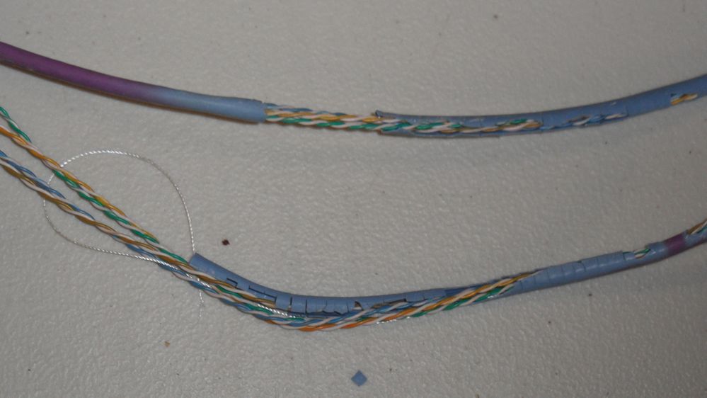

I purchased some purple sheathed CAT 5e cable years ago with an unspecified sheath, but assume it was low density polyethylene. This cable is excellent indoors as it is very flexible and is giving faultless service.
Then the learning: I installed a length at a friends house externally on a south facing wall, so it was getting full sunlight.
The following photos show the effect after about 3/4 years. The outer jacket has rotted away, leaving the inner cores exposed. These obviously use different insulation and the electrical connection was unaffected.
Lesson learnt: If you are running cables externally, use external grade cable.

I now understand that mains cable insulation is PVC with anti UV additives. Standard Ethernet and flexible data cables use low density PE. External cable is medium density PE (which is why it’s stiffer) with anti UV additives.

LDPE is susceptable to degradation with extensive exposure to UV.

I’m fully aware of that, now!
The problem is that when you buy Ethernet cable the jacket material is rarely specified. I wrongly assumed that the only difference between standard and exterior grade cable would be the thickness of the jacket.
The message I am trying to put across to anyone following advice to fit external Ethernet cable is: Either use exterior grade cable or fit a duct, ensuring that no part of standard cable is exposed to direct sunlight.
