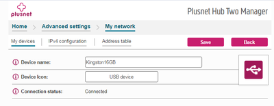

Hi, hoping someone here can help me as I've had no joy elsewhere.
I've plugged a memory device into the port and it shows up in Hub Two Manager/Devices, but there's nothing I can set/change there other than the device name and icon.
Q: I would like to share files with other devices on my local network, does anyone know if this is possible?Plusnet Hub Two USB.png

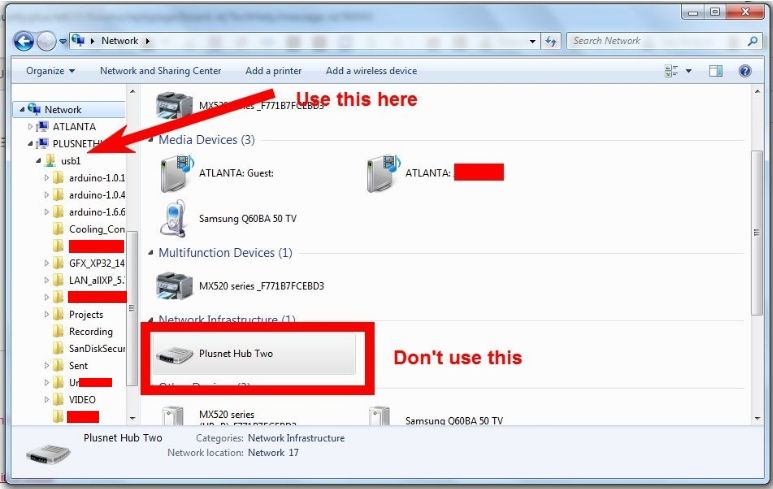

It's relatively easy to access it.. (I'm using Windwos 7).. Go to the start menu and then "My Computer" / "Computer" in the left hand pane, you should see Network - like on the screenshot below and there you can select the USB drive in your hub two.
I've just tested this for you using our hub2 and it let me put a file on the drive and delete it again so you should be ok.
Word of warning, I couldn't see mine straight away so I had to right click and click "Refresh". At that point windows then noticed it was there and displayed it to me.
screenshot-1627
If you double click the icon where I've left a comment saying "Don't use this" it will simply open the plusnet home page - it will not open the USB drive.

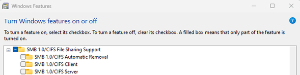

The underlying operating system for both Hubs use is a few years old now, although firmware updates/upgrades have occurred sadly they have not included the SMB version
You'll need a admin account with Win 10 and 11, you can enable SMB client here, suggest you only make this change if you're happy and understand the risks
The Hub Two can run in Bridge Mode (modem only device), so you could use your own router for file sharing, the router would need to support a WAN with PPPoE authentication. Clearly you'd need the space for an extra router.
