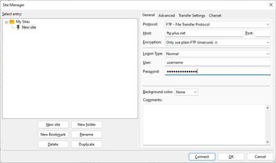

What FTP space are you trying to use? The Plusnet Homepages servers?
Open Filezilla, click File > Site Manager, and configure the server access as below (replacing 'username' with your Plusnet username): -
When you try and connect, you will need to accept the warning about plain FTP.
Anything uploaded to the remote server will need to be under the 'htdocs' directory.

I've configured the settings as suggested & I still can't connect.
Status: Connection established, waiting for welcome message...
Status: Plain FTP is insecure. Please switch to FTP over TLS.
Command: USER supanet6
Response: 331 Password required for supanet6
Command: PASS ************
Response: 530 Login incorrect.
Error: Critical error: Could not connect to server
Ideas please everyone
