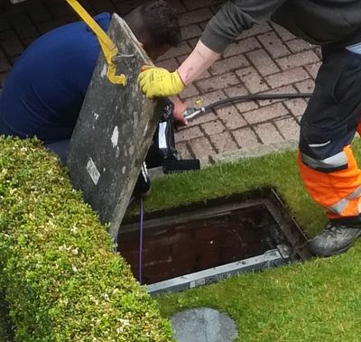

CF were back at the chamber today. They seemed to be air pressure testing the duct.
The silver lever arm holds the OR CBT and folds up to allow work on the CBT.
