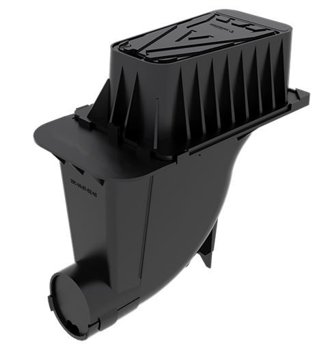

City Fibre have only carried out the infrastructure work in our street. They have laid bundles of very small, empty conduits, (they apparently call these 'straws') in the pavement. There are empty sockets installed in front of each property at the back of the pavement ready for the fibre to be run and connected back to the street cabinet. The cabinet is a long way down the street, so I'm not sure if CF have done any work in this cabinet. I have seen them (or one of their sub-contractors) working in a cabinet some way away, but it's not easy to know if our nearest cabinet is ready for the fibre to be distributed.
Does anyone know what the diameter of the fibre cable that runs from the pavement socket to the house is?
Posts: 6,012
Thanks: 2,255
Fixes: 118
Re: Fibre installation process
@bigfish
When you say empty sockets in front of each property do you mean something like this.
This is called a Toby Box and only the top part is visible from the pavement. If it's not can you post a picture.
I think it is probably 5mm duct that runs to your house. That appeared to be the approximate size of the bundles added to the chamber serving me,
