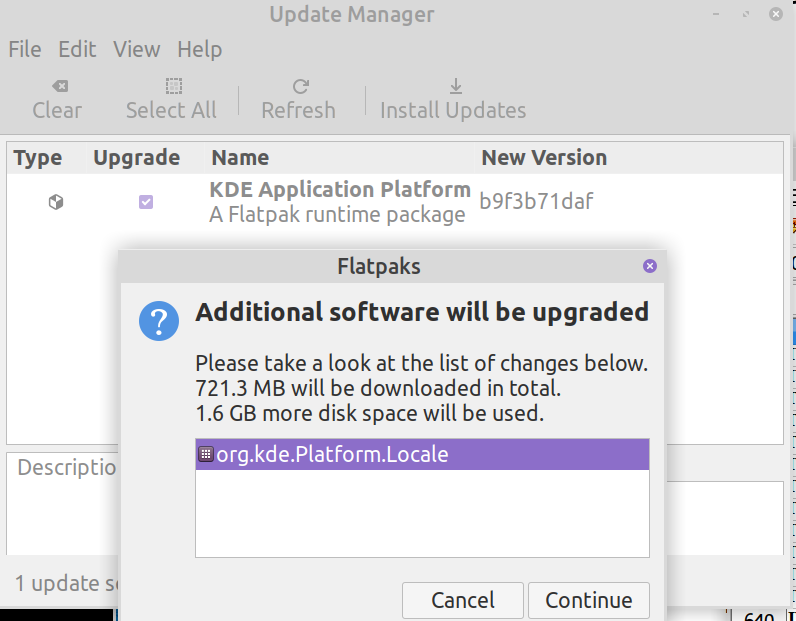

I keep getting notifications of FLATPAK updates which inform me that it will take up 1.6GB of disk space on my HDD.
I have a 500GB hdd installed, of which , currently it is almost half full.
In the past few weeks I have seen several of these "flatpak" updates ( and installed them ) . but I have no idea what they do, or if I need them.... !     Assuming I get 1 per week for the rest of the year...  (35 weeks 4 days to Jan 1st 2025) then the updates will take up ANOTHER 56GB on my hdd .
Is there any way of getting rid of "old" flatpak updates, or does the new update overwrite the previous one ?   from the notice, it seems that they do not...but, I just wondered how I can make space on the hdd which may well be redundant due to the newer updates.

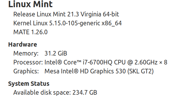

machine is ASUS ROG 752VW

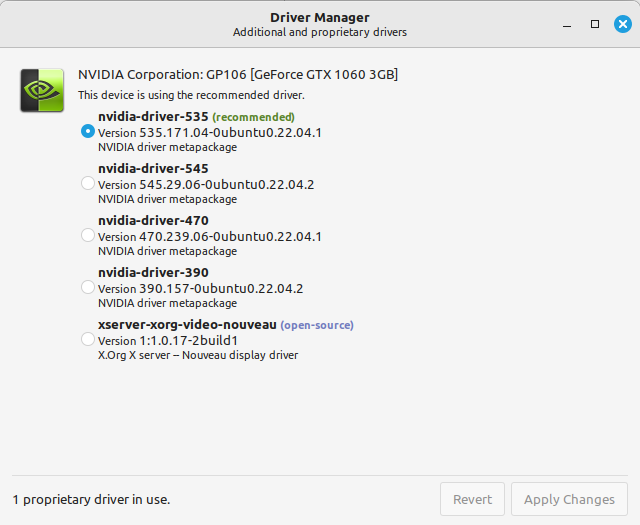

Re: FLATPAK updates query
@MisterW
When I run Mint's Driver Manager, theScreenshot from 2024-04-28 13-19-12.pngScreenshot from 2024-04-28 13-19-12.png is the result:
So only one version of nvidia-driver-535

@shutter wrote:
@TheRoadCrew  Thank you for your very informative and helpful reply.

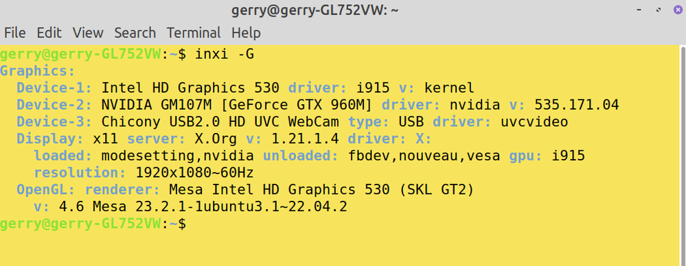

I would expect a Republic Of Gamers machine to have discrete (Nvidia) graphics yet yours only reports the integrated Intel graphics hardware. It's conceivable Nvidia could be disabled in BIOS or otherwise powered off but I'd be interested to know the output of
$ inxi -G
You have multiple Nvidia runtime flatpaks installed which are reportedly unused but 'pinned' to prevent removal.

here is the result of    inxi -G

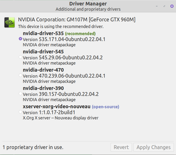

 And on suggestion from @Anonymous   Here is a pic of the Driver Manager
 This laptop was "gifted" to me, by another PN user... and is not used for gaming, or anything that specifically needs ( I assume ) Nvidia graphics...  used for basic surfing... watching YouTube vids and not much else.   I do have a USB DVBT tv slotted in, and watch live Freeview on that, which saves running a telly at the same time !.

TheRoadCrew
Posts: 176
Thanks: 68
Fixes: 13
Registered: ‎14-05-2017
Not connected to any Neflix or subscription services.
If you're not actively using the Nvidia chip I'd suggest switching to the Nouveau driver. Reboot and if everything is working to your satisfaction look at removing the Nvidia runtime flatpaks.

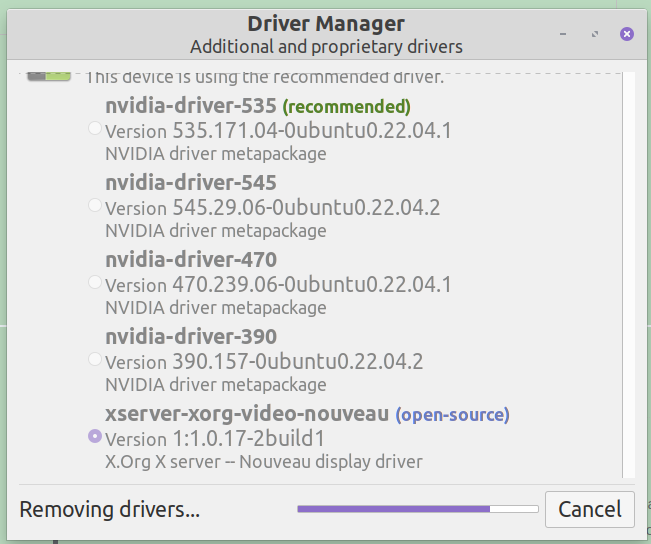

shutter
Posts: 22,424
Thanks: 3,879
Fixes: 67
Registered: ‎06-11-2007

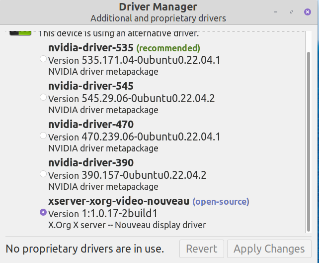

@TheRoadCrew  Thankyou for the instruction !.. have been to Driver Manager and selected the Nouveau driver, and done a reboot...
And after Re-Boot
Will set about removing the flatpaks later on this evening
Thanks very much for your help.... Much Appreciated.  Smiley
