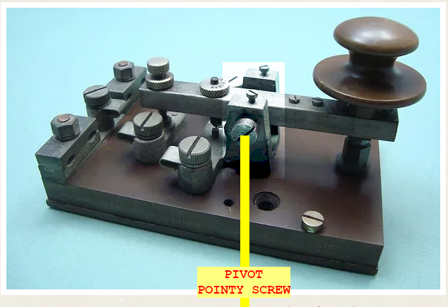

One of my morse keys needs the pivot threads to be re-drilled and tapped to the next size out..
At present, they are 6mm, so the next size up would be 8mm .
Drilling through about 10mm of solid brass. As already drilled and threaded, should not be too difficult to follow through with a bigger drill bit ,
What size drill bit(s) should I use to ensure that the 8mm tap will give a good cut , and not be "slack"

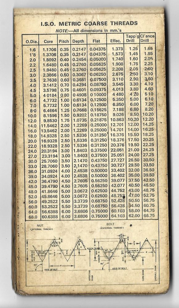

Hmm.   Will copy that and then enlarge it, to be able to read it ! ! ! ! ... cheers  Cheesy
Done ! ... but I still don`t know which size drill bit to use ! ! ! ... HuhTongueUndecided

Larger.
Which drill? Of course if you're doing it with a hand drill it will depend how steady your hand is. So at the end of the day it will still be a bit of trial and error.

As the hole and thread are already through the brass shoulders, it`s more a case of just widening the diameter of the hole, leaving sufficient to tap the new 8mm thread into it..
Originally it would have been a British Thread,... being made during the 1930`s,  but over the years of abuse by hundreds of different "fists" ( wireless telegraphists ) ... the threads have worn somewhat, and are not fit for purpose... i.e. the "pointy screws" that act as the pivot point can "wobble", slightly, which upsets the way the key works, causing errors in transmission.

Just to explain the "Pointy pivot screw"
being replaced with this.... https://www.ebay.co.uk/itm/401859514894
M8 A2 Stainless Cone Point Grub Screws Hex Socket Set Screw DIN 914
Note.... Drill Bit Sizes available....6.5mm   7mm   7.5 mm 8mm
