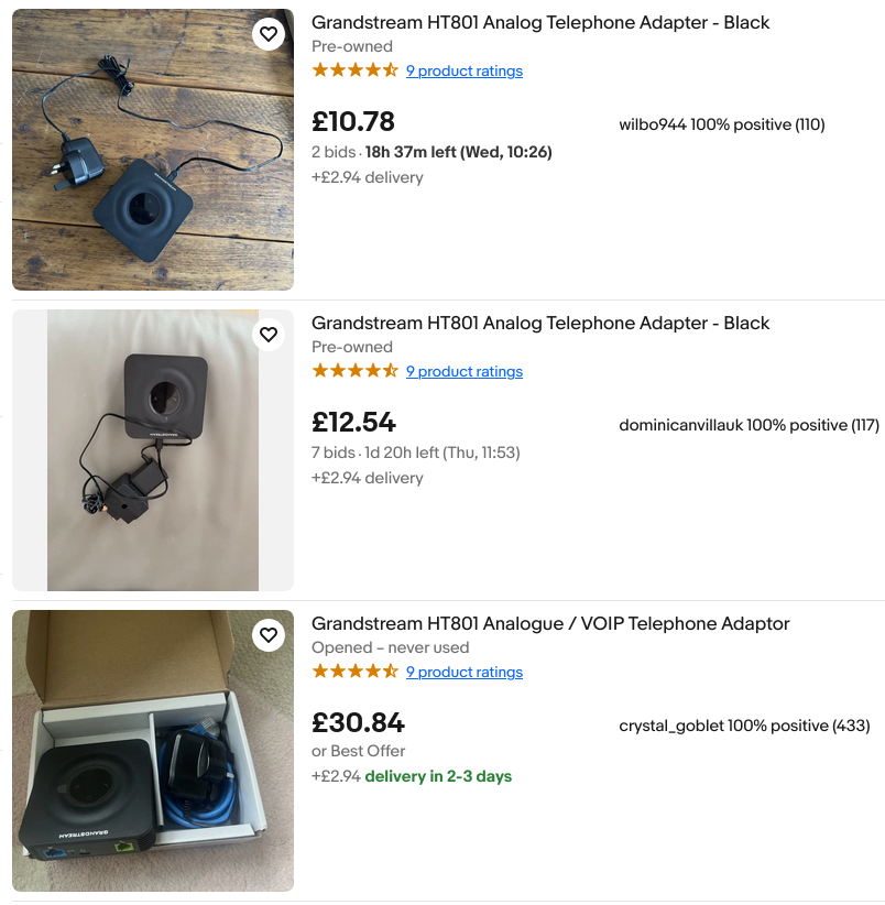

Note that if buying new, then you might as well get the updated  Grandstream HT801 v2
@SomeOldCodger wrote:
I've seen them on Amazon new for just over 40 quid
or less on eBay -
Screenshot 2025-09-16 at 15-48-34 Grandstream Ht801 for sale eBay.pngScreenshot 2025-09-16 at 15-48-34 Grandstream Ht801 for sale eBay.png
