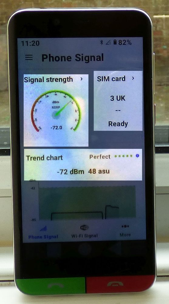

As a comparison for EE SIM (middle phone above pics)  ( non active- data expired )  and THREE SIM,  signals strength... here is a pic of a non-active (in abeyance) SMARTY sim on THREE network.
                          ARTFONE 500            SMARTY SIM      THREE
From this experiment... i have now found that I am able to use MVNO`s on the THREE network.. ( not many, I know,..but a good alternative network signal strength) .
