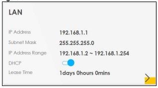

You'd need to log into the router at 192.168.1.1 and click the arrow bottom-right of the LAN details: -

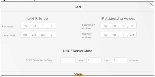

This will take you here: -
Enter details as follows and then save the changes: -
IP address: 192.168.1.254
Subnet Mask: 255.255.255.0
Beginning IP Address: 192.168.1.2
Ending IP Address: 192.168.1.253
Once saved, your browser will likely lose connection with the router. I'd suggest at this point waiting a few minutes and then switching the power to the router off/back on again. Once the router has reconnected, you should find that you are then able to access it again, but this time using the address 192.168.1.254.
