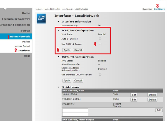

Posts: 5,005
Thanks: 3,315
Re: A tale of two Rokus
@bobw1943
This is the answer you seek, make sure you use a wired pc. Follow the numbers in order, then make the IPv4 Address 192.168.1.1  Once the change is committed you need to reboot. Then it can be connected to you local

Posts: 5,005
Thanks: 3,315
@bobw1943
A thought, you'd best change the IP Address before turning DHCP off.
bobw1943
Posts: 78
Thanks: 7
Registered: ‎19-04-2016
Thanks for your time.
When I follow your directions I see something different.
Posts: 20,442
Thanks: 9,278
Fixes: 585
Just click on the 'LocalNetwork' link ( shown in blue ) and you should be there .
Probably slightly different firmware to @Dan_the_Van s
