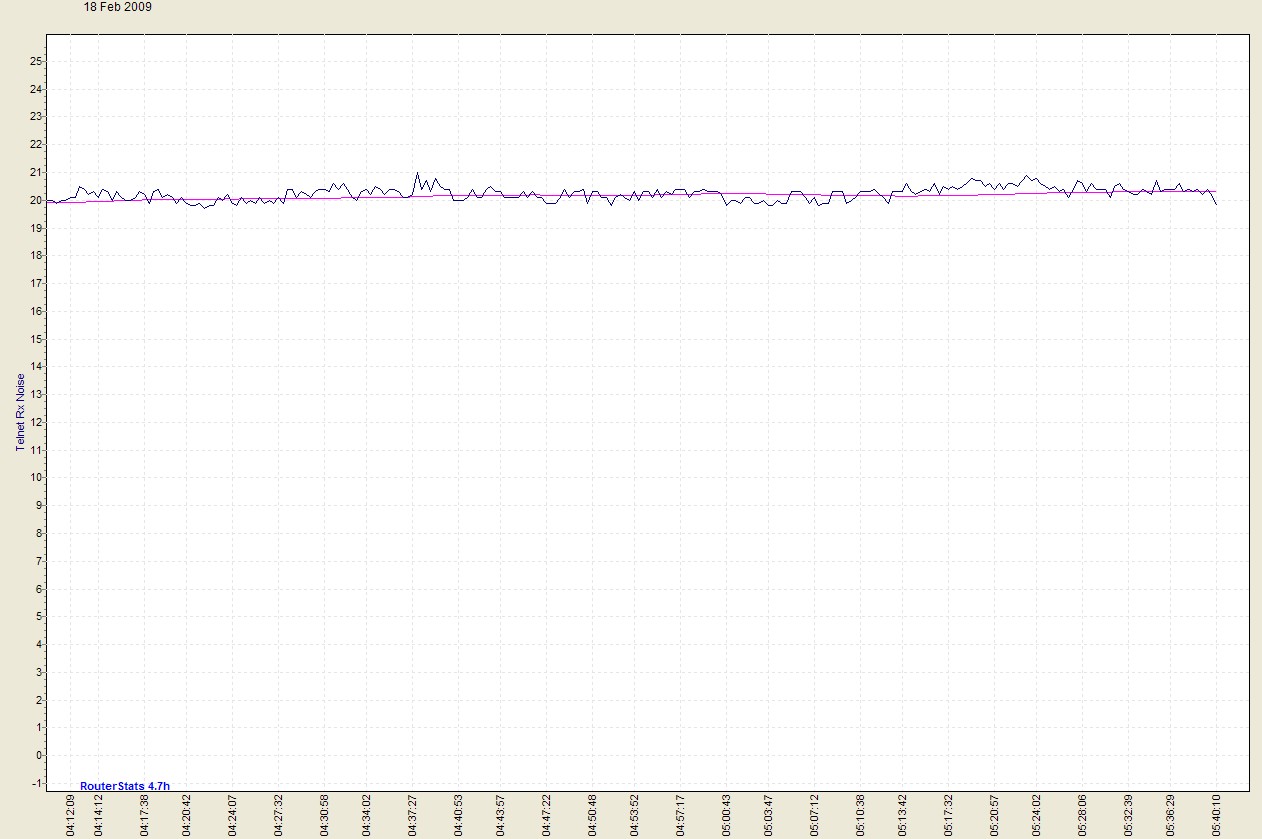

Yes, you're right - I didn't do this because the sync rate graph just had a straight line (at 2304kbps), but I should have mentioned this.
The noise margin graph changed again at 21:46 and the periodic peaks disappeared. I also tried a router reboot at 22:27 and this resulted in a slightly higher sync rate of 2784kbps. I've attached some more graphs to illustrate this.
Catweazle
Posts: 140
Registered: ‎12-01-2009
Re: Unresolved support ticket open for more than six months - is this a record?
And here's a graph of the current noise margin (sync rate is a flat line graph at 2784kbps for the corresponding period).

That change shows that, whatever the problem is, it's pretty massive - the pulsing is only a minor fluctuation.
I think this needs some serious investigation and you'll need the help and understanding of PN to get it done. You've got loads of evidence that they (and BT) can't realistically ignore.

First, I forgot to comment on those noise drops to zero in reply #185, that is likely to be a router polling issue (there was no change in sync) and if so can be ignored.
Secondly, as this pulsing has now disappeared after the re-sync it could just have been some very strange interaction between the line card and the router at that particular sync rate.

I've attached another noise margin graph as the periodic peaks reappeared briefly at about 18:26 (the sync rate stayed constant at 1600kbps so I haven't included this graph). My router indicates the latest disconnection was about 15:40 this afternoon (when I was at work and the pc was switched off).

Very weird that, but the same pattern as before.
Came on for about 15 minutes with a huge level of interference and a steady pulsing pattern every 6 minutes or so.
Any idea what your target SNRM is now?  Cry

Just rebooted the router and this is showing an SNR margin of 12.0Db (was 25.7 before), line attenuation of 26.0Db (was 25.0) and a sync rate of 4768kbps (was 1600).

Forgot to mention that download speed (according to Mybroadbandspeed and Speedtest.net) is still around 1200kbps.
